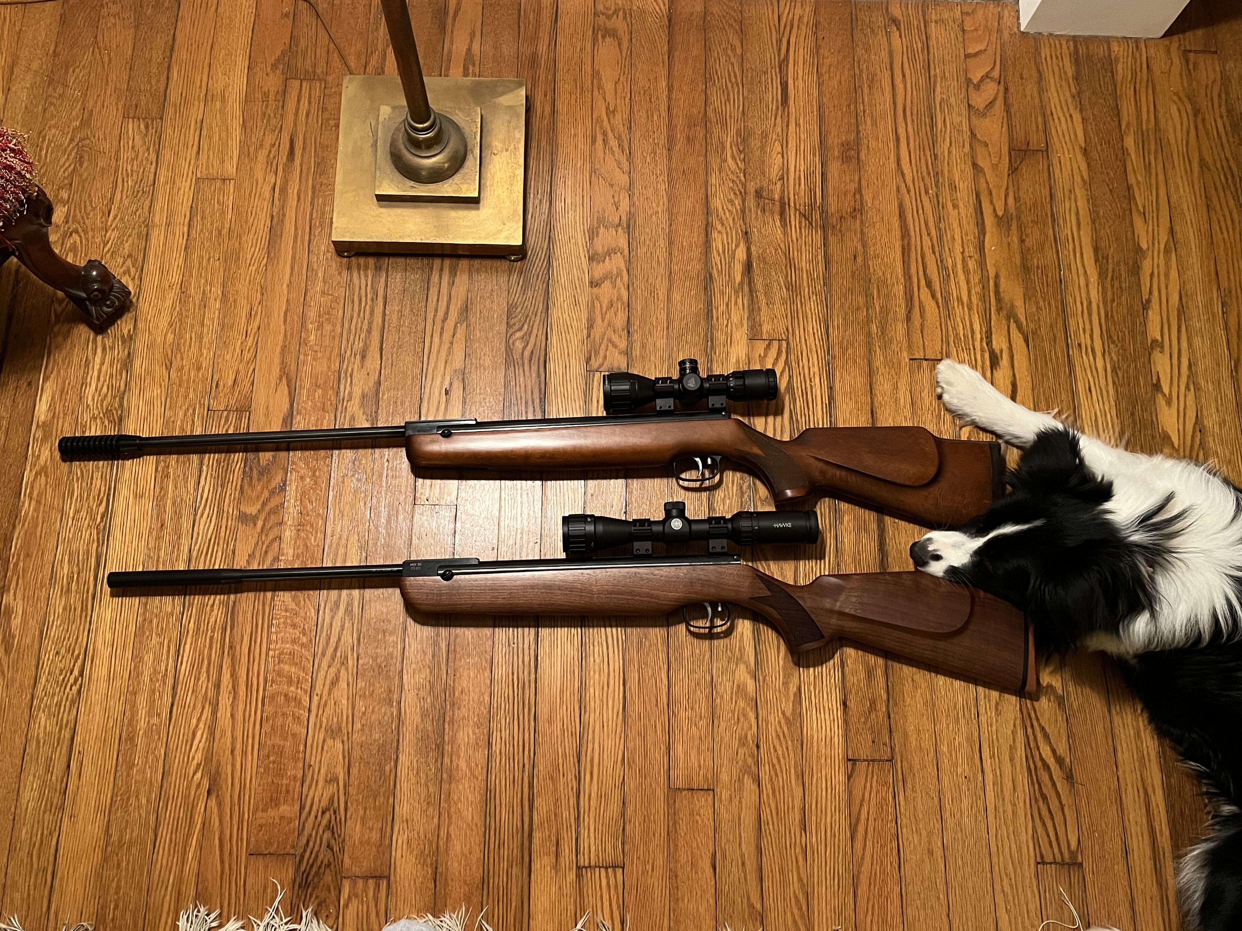

Will Beeman R8 action fit a Weihrauch or ARH stock for the newer HW50?

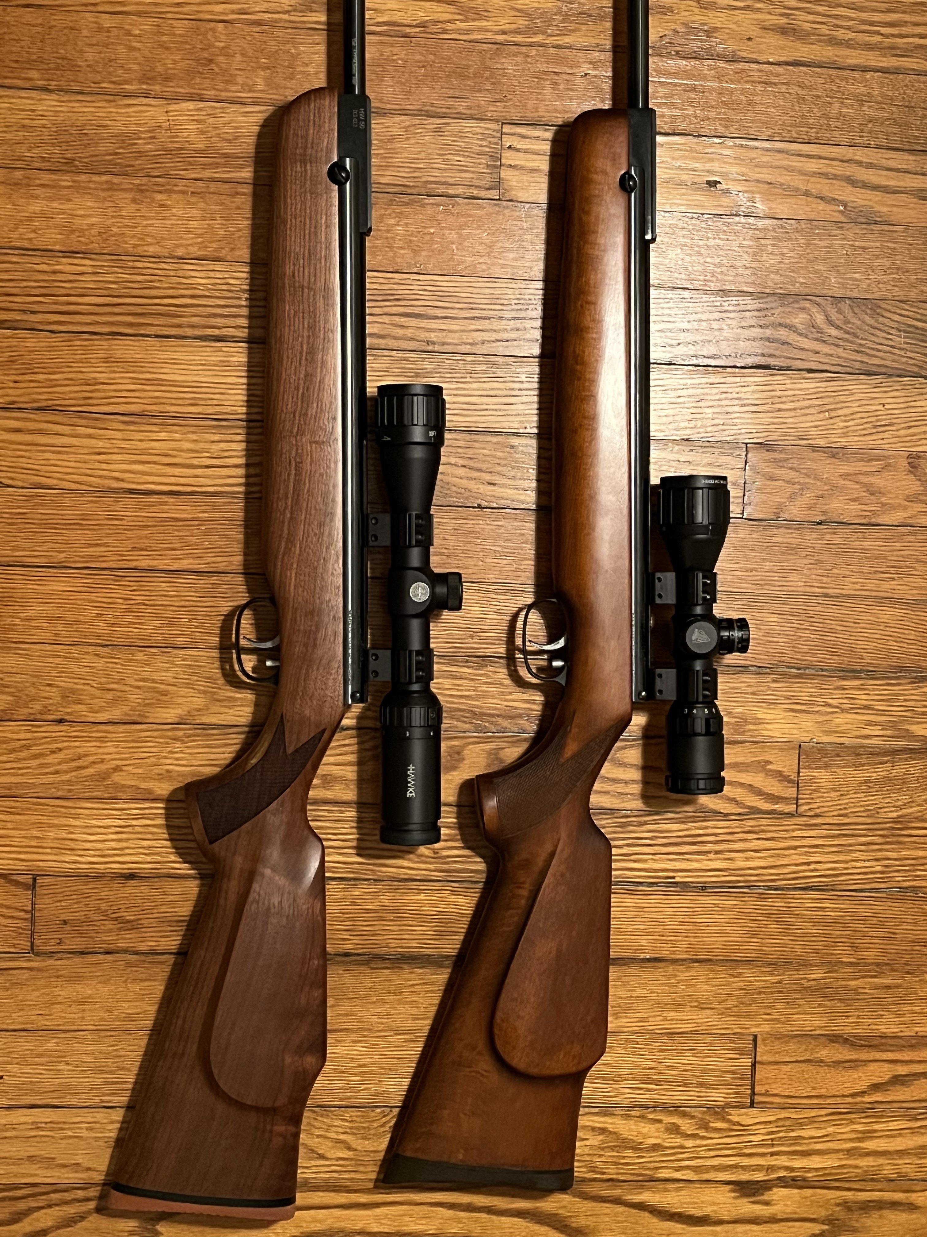

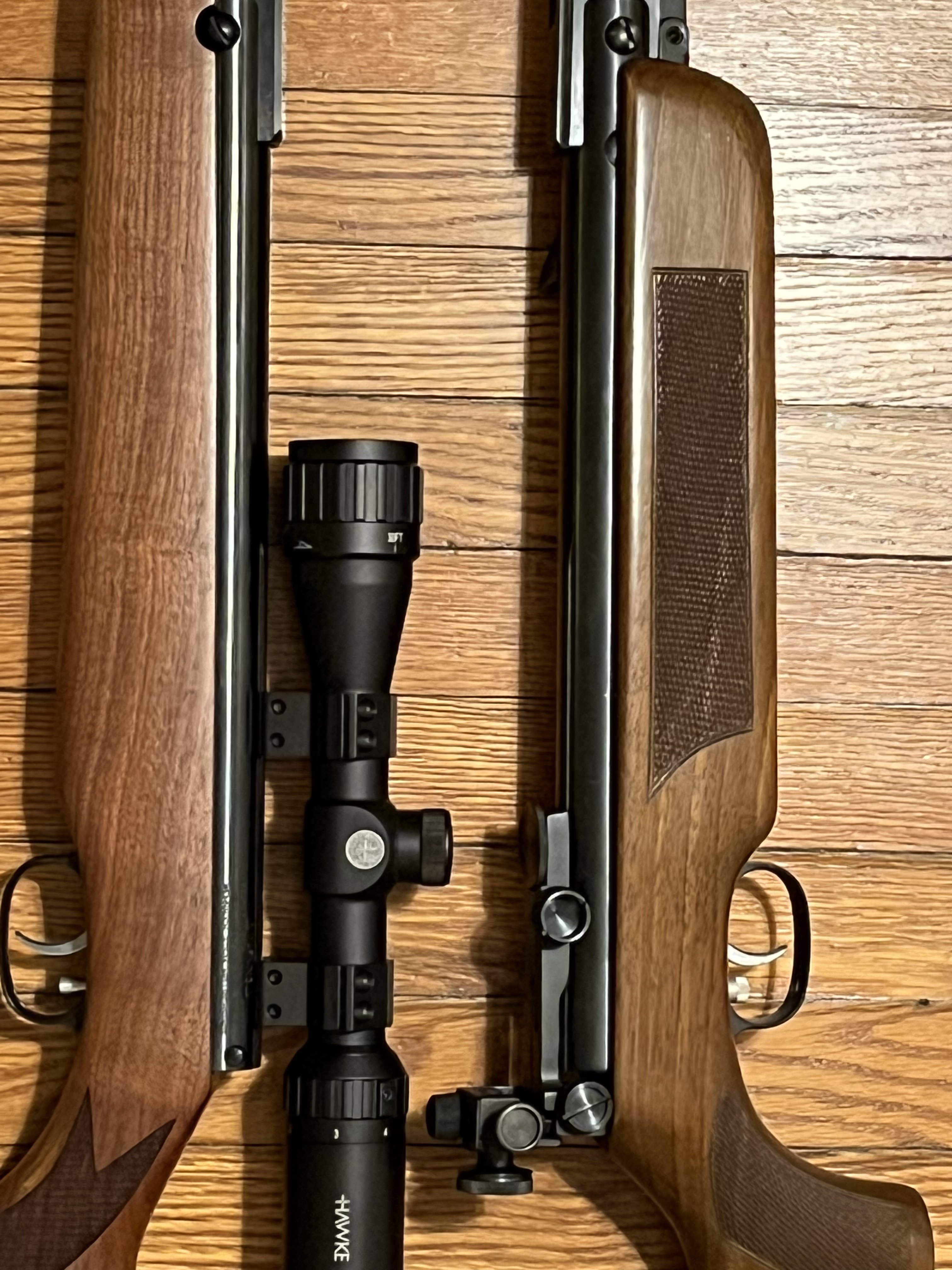

Side by side the ARH and the “Not really a Goudy” stocks look like they’ll swap. Just like ARH said. Lucie had to get in on the act.

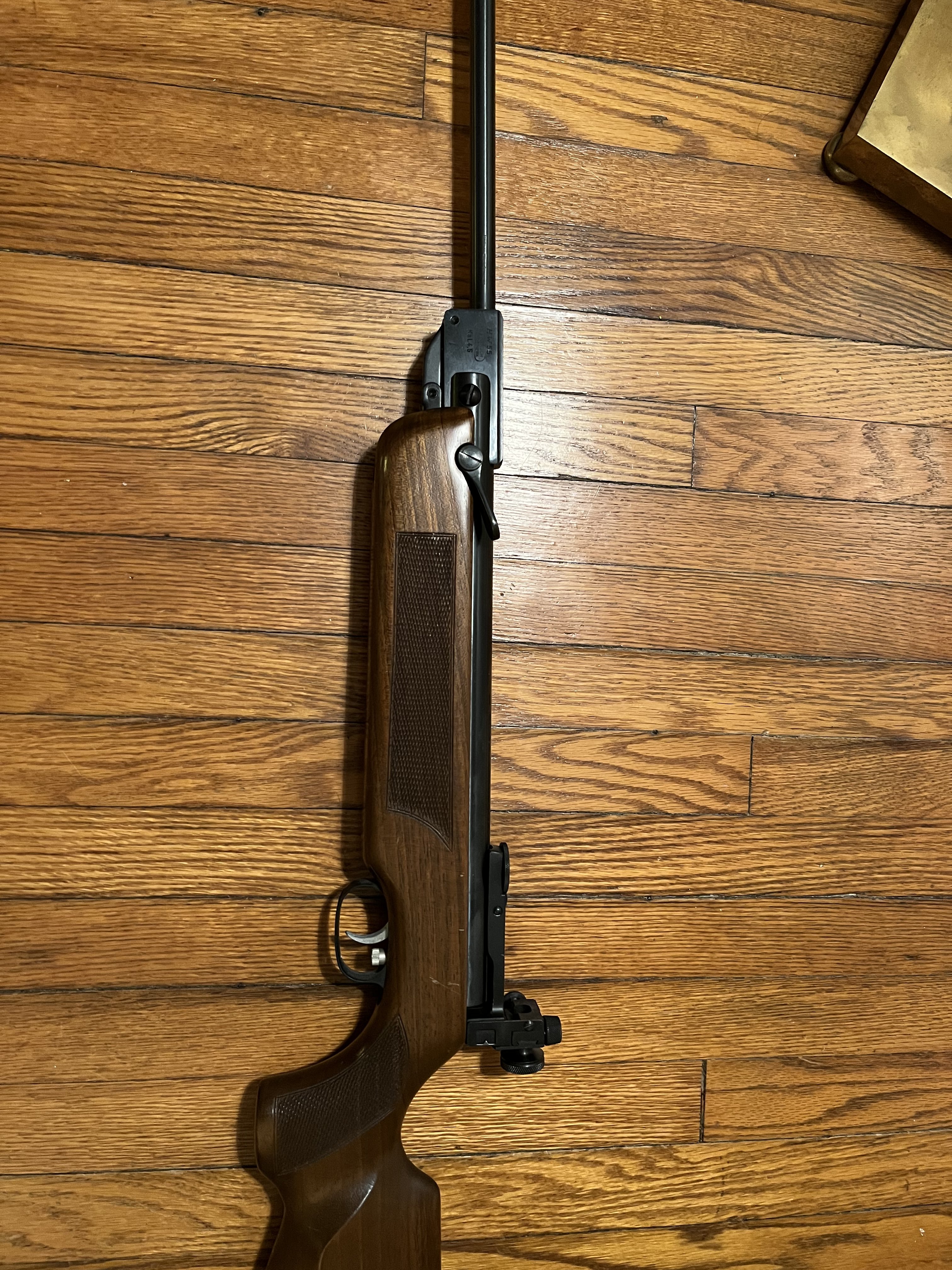

Does someone out there have the R8 or HW55 and a “newer build” HW50 that could just switch the stocks around to see if the action fits the stock and the holes line up? The post was written to see if a custom stock was ordered for the “newer build” HW50, would that stock fit a R8 or HW55. We already know the R8 and HW55 will indeed swap. The relief in the stock would of course have to be made for the lever on the HW55. This information would open doors for anyone wanting to customize an R8 or HW55. Thank you
