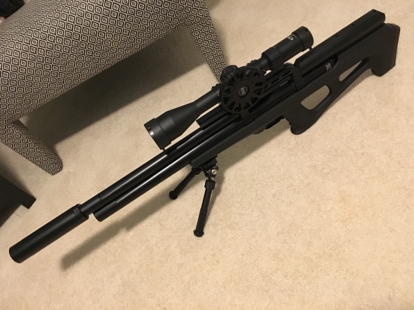

Here's a shot of a .25 with a Sumo added. Very happy with how quiet it is.
