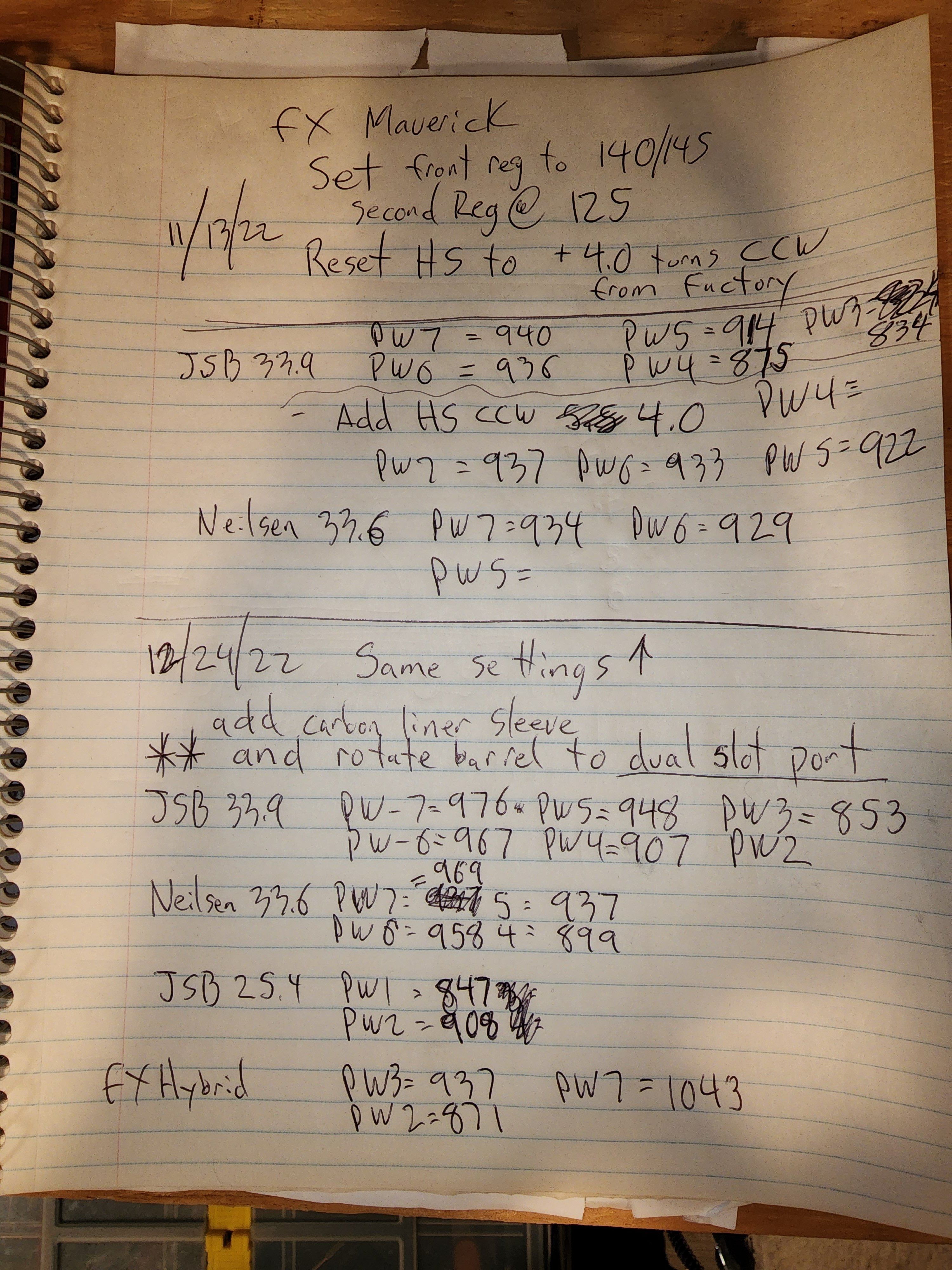

Note page for the tune I am getting ready to test on my .25 Maverick 700mm. Same settings that you are talking about. You can go lower on your settings and still push the 33.9 grain JSBs to 900+ fps. The JSB MK2's generally do best in the 880 to 910ish fps range for FPE with great accuracy. I have not used the Hades but 880ish fps is what I remember reading members tuned to for them.

Thanks for that information. How many shots were you getting in the king heavies?
