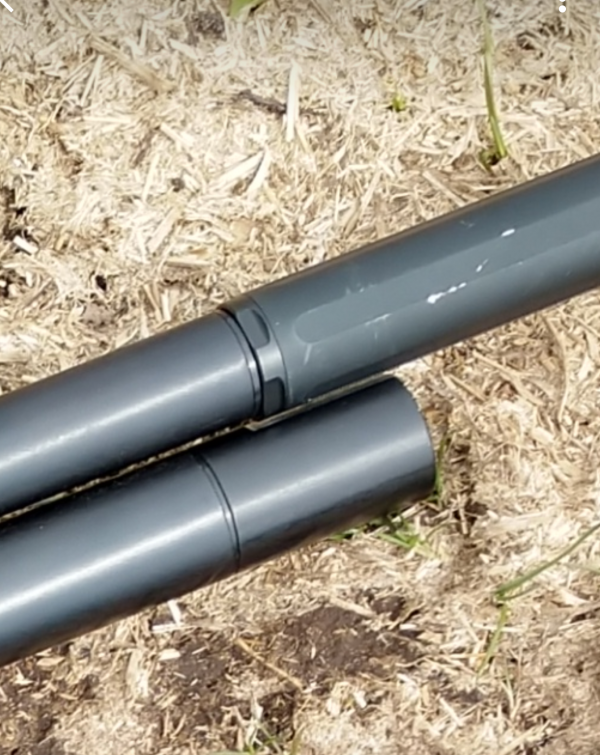

Due to variances in manufacture/build between one FX Wildcat and the next, the 1.2" diameter of the KOI and Tanto might rub the fill port dust cover like on my rifle. There are some WC owners who fit the KOI directly to the shroud with no clearance issues at all.
I had to mod my fill port cover so I could run the KOI directly off the shroud without interference. The advantage of running directly off the shroud is it saves weight and shortens overall length.

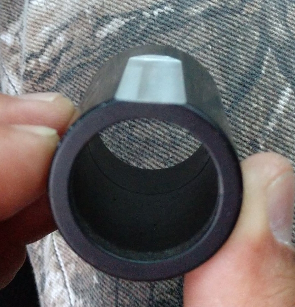

Here's a pic of my fill port cover. I took it to a local machine shop and they milled a flat spot as you see here. Now the only time it touches is when I am filling the cylinder.
View attachment MTUyOTAwNDI0OF81MjgyMzA1MDViMjJjMGQ4MzU1ZTczLjU4MzY5MzQzX0lNR18yMDE4MDYxNF8xNTEwMjZfMDF+Mi5qcGc=
Here is how it looks in place:
