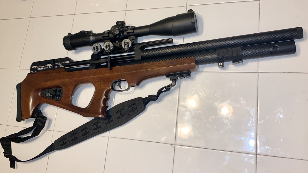

Wildcat MKIII Sniper .25 - Performance & Accuracy (post-mods)

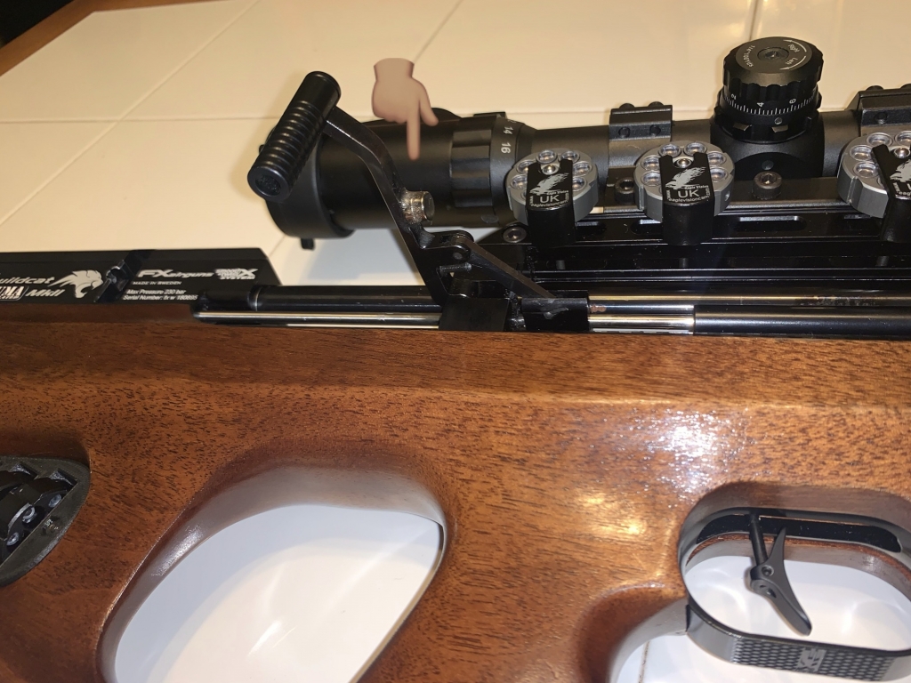

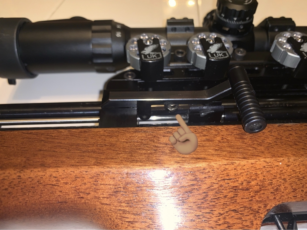

Hey Joe, on my gen 1 WC the cocking lever will move forward from the full "open" position if the rifle is tilted forward/down. The probe is then partially blocking the clip from being inserted. Has FX incorporated something into the MK3 to hold the cocking lever fully open? (Maybe they did this on the MK2 as well)
Also, absolutely believe your shot groups because I know what my MK1 can do - but the shooter (me) is not always up to it. Lol
Rodeo, it’s funny you bring this up. A member on here came up with a sweet idea that he did on his WC to prevent that from happening, and I’m taking it another step to correct that situation. I’ll post up what I came up with in pics on another tread.
Cant remember the members name, as it’s been awhile. He was selling his gun on the classifieds and I saw a mod to his gun that caught my eye when he posted pics. I sent him a pm and he explained the mods purpose. Genius idea.

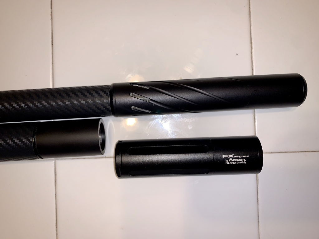

JKool,
Can you recommend a suppressor of the same diameter, 20mm if I am correct, as the shroud for the "Compact" version, that will accommodate the added "Plenum" length, which I believe looks the same as the Dreamline plenum in your photos.
My Wildcat MKII and DreamPup occasionally does this, but it is a rare occurrence. Once I got a little happy with my Ballistol oil dropper lubricating some of the moving parts on my airguns and that’s when I noticed the cocking lever doing what you describe. Since reading your question/post I pointed my Wildcats down and cocked them, just to see if they were doing it, and they weren’t. So it is not a problem for me, the easiest fix (hack) for that would be to just hold your Wildcat level or slightly upward when loading a magazine. Gravity... lol.
One modification I have done with my Wildcat MKII is epoxy two rare earth magnets to the inward side of the cocking lever. I did this years ago because it would do the reverse of what your cocking lever is doing. When I would close the cocking lever it would swing open. So I fixed (hack) that with the magnets, and now it has a satisfying “SNAP” when I close it and stays there like if it was designed that way from the factory.
JCool,

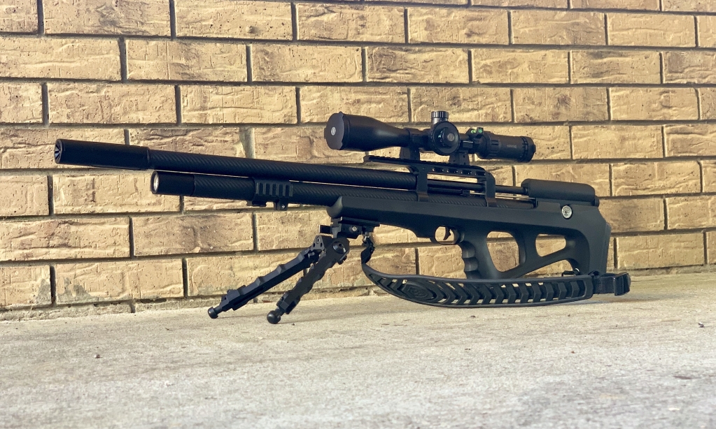

Huggett moderators are on the expensive side but...
I would recommend the old school “Huggett standard”. I believe it maybe called the “Huggett Snipe” now a days. That is what I’ve had on my FX Streamline .22 since 2016. It is super quiet! I tried it out on the MKIII so you could see (see picture).. The diameter is a few millimeters thinner then the FX DonnyFL moderator.
There is also the “Huggett Belita” which is shorter but has the same diameter width as the “Huggett Snipe“.
A third option would be the “Huggett FX Wildcat Dedicated Shroud” which may be the coolest option. It replaces the entire WC shroud with a new shroud with a built in Huggett moderating system. You would have to choose the correct length on purchase for the 500mm barrel compact though it is probably the same width as the original WC MKIII shroud so, there’s 3 options...
Oh, and I almost forgot about the “DonnyFL Tanto” is a narrow and compact moderator that is also surprisingly effective in sound moderation.
Links:
https://utahairguns.com/huggett-snipe-standard-moderator/
https://utahairguns.com/huggett-belita-moderator/
https://utahairguns.com/huggett-fx-wildcat-dedicated-shroud/
https://utahairguns.com/donnyfl-tanto-moderator/
Correct me if i’m wrong but isn’t that shroud only go up to 600mm where the mk3 in sniper is 700?
Your probably right, but UA does have the option for the 500mm barreled compact. Which is what the question was about. These Huggett shrouds were released before FX began putting 700mm STX barrels on Wildcat MKII’s.

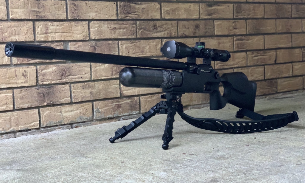

My FX Crown .25, Huma regulator @ 175 bar, 67-68 fpe, additional hammer weight (allows me to open the valve at that high reg. pressure), 600mm STX Superior Liner, accurate as hell! (Balanced)
My FX Wildcat MKIII .25, AMP regulator @ 135 bar, 67-68 fpe, stacked plenums & larger transfer port, 700mm STX Superior Liner, accurate as hell! (Balanced)
