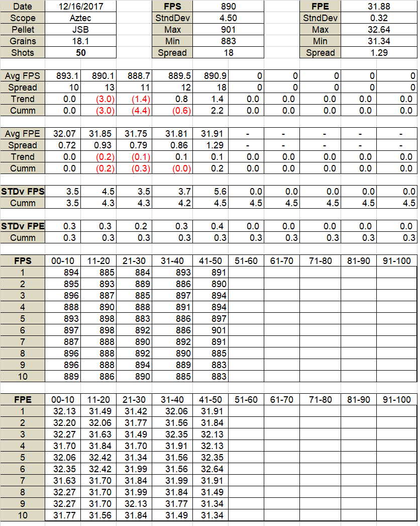

Just an example of what I could do with the chrony data. I haven't retested this since (18 months if my date is right) as nothing seems to have changed on target. .22 WC MKII after I found a happy place for the HS. Never touched the reg on this one. It's my .22 WC MKII.

what is the expected FPS change per 1/4 turn?
Well some may disagree, but I have found them to be a little touchy. Mine (I've had them all and still have a .177 MKI and the .22 MKII) had a rather small range within they worked best. That may be related to the regulated pressure the hammer needs to overcome to open the valve. So in my experience, there is no good answer. I wouldn't go more than a 1/4 turn at a time, maybe a 1/2 turn.
