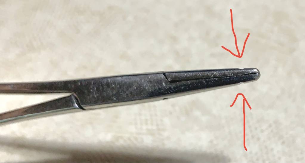

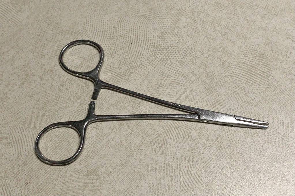

The best way is to file a small notch in a pair of hemostats. When you pull the seat out you will have to apply a decent amount of force to keep the pliers open so the hemostats don’t slip out. I have used this a few times and it does the job! Good luck bud!
