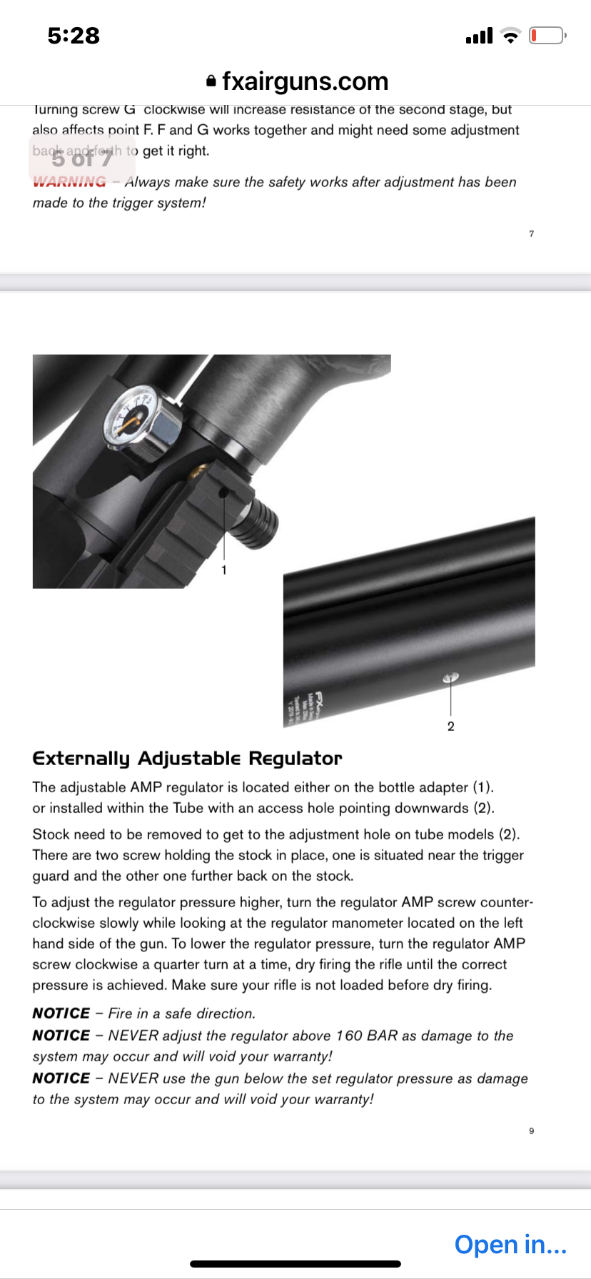

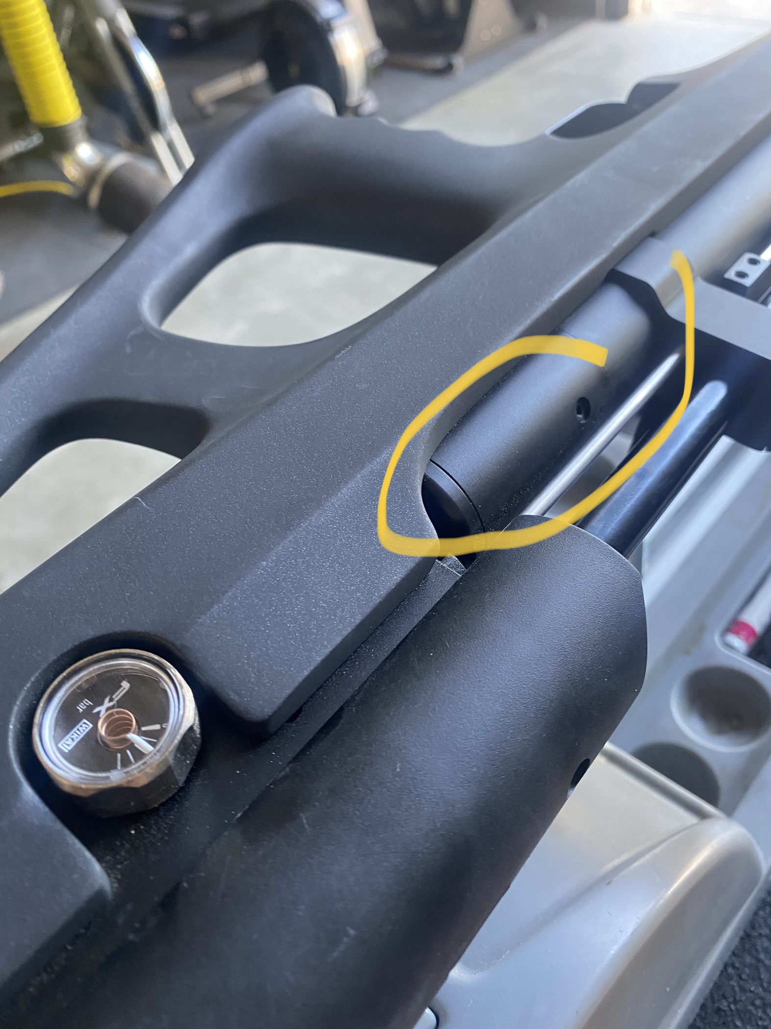

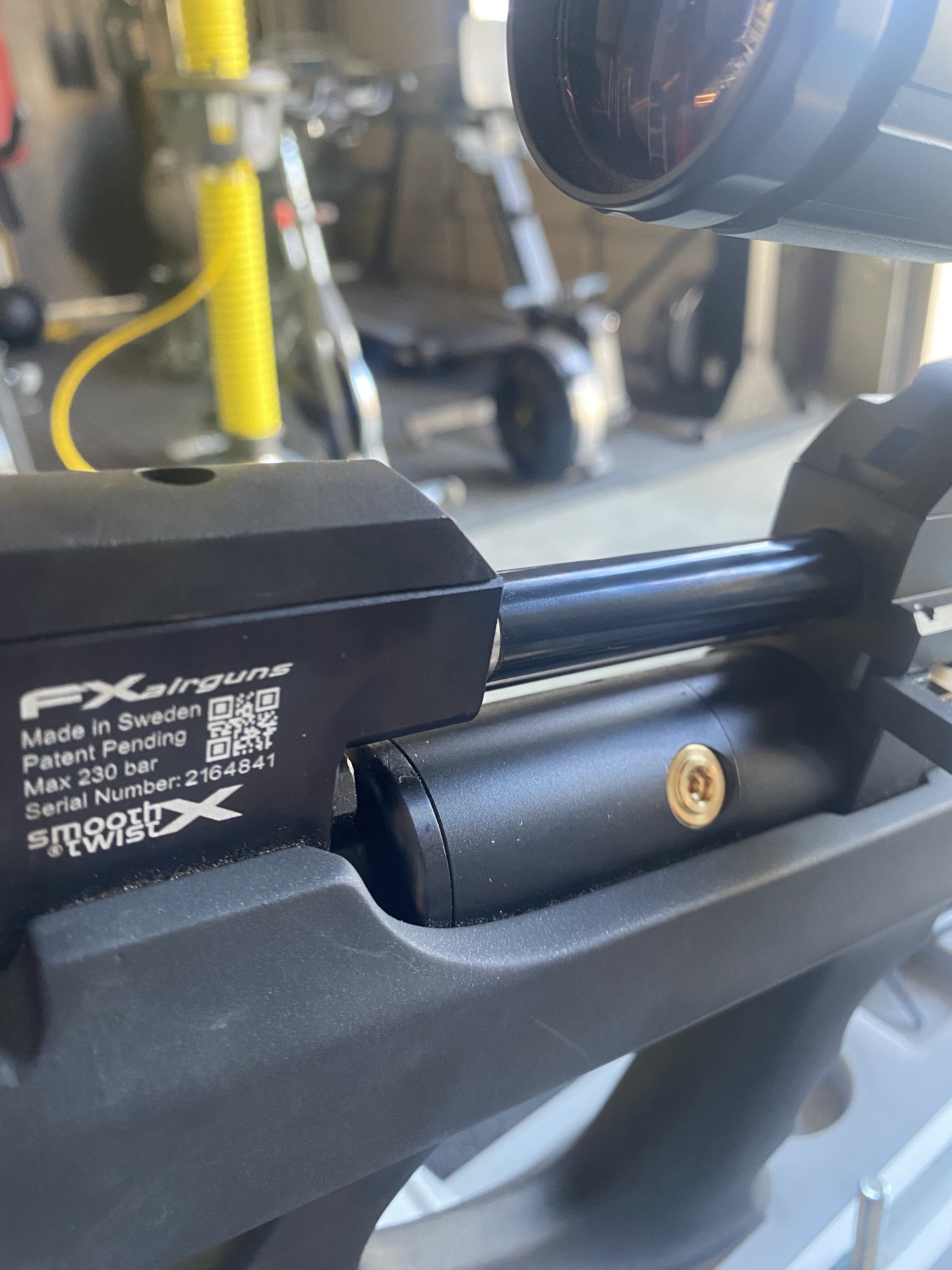

Hi all, I’m new to air rifles and this site. Thanks for having me. I pulled the stock off per the instructions and there is no adjustment as shown in the manual. Looking online it says the brass adjustment on the exterior is the reg adjustment. Maybe its a recent upgrade? There is also the screw circled in yellow in the attached pics but I’m pretty sure that’s not it. Can some one confirm I’m moving the correct screw before I mess something up?

You're correct, the visible brass adjustment fitting is an upgrade. My older MK3 Wildcat (Serial # 01040**) has adjustment under the stock, as shown in the manual. As I understand FX wanted to provide easier non-stock removal access for regulator adjustment. You can always contact FX-USA to verify, but this matter was addressed not long ago when one of our members, Grumpy, (I think) raised the same question. Do an archive check on "Wildcat Regulator adjustment" to try and find thread. Best of Luck, WM

The Wildcat MKIII is a dual regulated gun. There is a regulator as shown in your manual under the picatinny rail just behind the bottle. There is another on the plenum.
The Wildcat MKIII is just aMaverick with a different stock or vice versa depending on your perspective. I you go to the search bar on this forum and put AEAC Maverick tune there is a comprehensive guid to tuning it. You need to adjust both regulators and have the first reg around 30 bar higher than the second one. The process is relatively simple but would be much better to watch the video than have me try to explain it in detail.

In your picture of the brass regulator, that is the second stage regulator. Mine is under the stock. The first stage regulator is in the picture from the manual that you posted and that looks like it's a picture of a Maverick. Same gun under the stock. Again that first stage regulator is under the stock of the WC, also.
This video explains working with the dual regulators. He's working on a Maverick, but it's the same gun. You just need to take your stock off.
