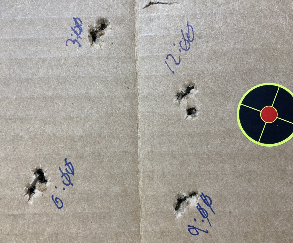

K, was able to get back at this today. Also called (no answer) and emailed FX questions about the Wildcat and M3. In the meantime I decided to dig into barrel indexing. The barrel nut was very tight. Liner was straight when referenced against a ground cast iron surface. Possibly it could have been bent under compression of the barrel nut, but I'm not sure. I made a witness mark on the liner and fired three-shot groups with that mark at 12:00, 3:00, 6:00 and 9:00. Here are the results:

Does this mean I should fix it between 12:00 and 3:00 to 9:00 and 6:00? That's somewhat in the middle and offset can be compensated by elevation only. The point of aim was the target on the right. So, 12:00 and 9:00 are the closest POI to optical center, but are closer to the horizontal extreme. Hope this makes sense. Thoughts? Thank you.
Your assessment is correct. Didn't know if I should put it closest to point of aim or middle ground horizontally. Appreciate the guidance.
