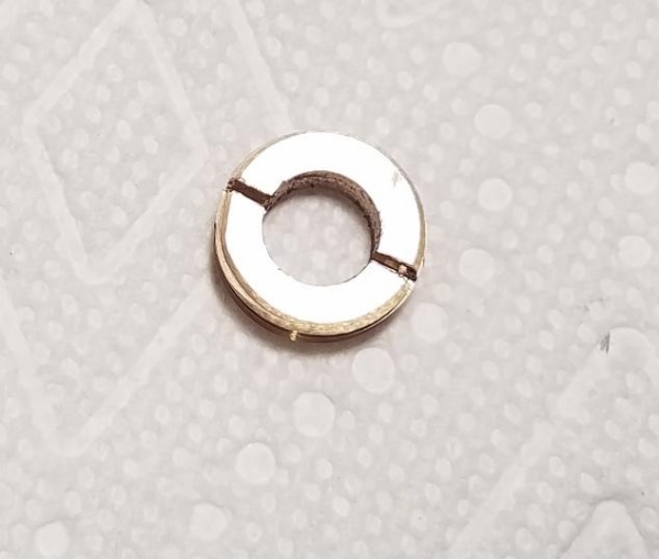

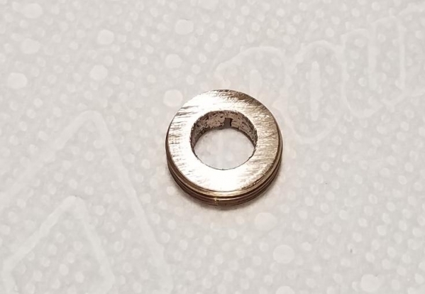

I just used my dremel and made a slot across the top. It fits perfectly and I don't have to chase down the wrenches. It gives me both options.
Now on my WC 25, that little thin nut there is on the verge of stripping even though I heated the loctite and it turned out rather easily. That nut is a piece of junk. So the one in the 25 is black and easier to tear up. The one in the 177 is brass and very solid. I looked at them and they both look the same. So I ordered another brass one for the 25. We'll see if that works.

It just scews in the threaded hole behind the hammer spring adjuster. Then the adjuster is backed up a tiny bit to lock it againist the brass jam screw. The hole is so you can get the hex wrench in the adjuster to lock them together so you don’t lose your hammer spring ajustment. Chuck look for your’s in the mail next week. CH
