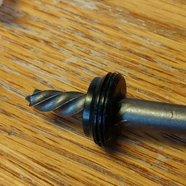

What screw is actually being adjusted. Is it the first Allen hole in the large receiver hole. This almost seems like a cover, not very heavy duty. Mine came out easily even with loctite on it. And your counting twists from when it first engages the receiver. Thanks for the help guys. I have not changed the regulator yet. The factory regulator has a pressure of 135 being measured with a gauge in the air bleeder hole.
Here's how I had to get mine out.

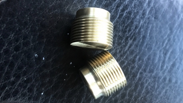

I’ve solved my dreaded weak easily stripped hammer spring adjuster screw problem here’s how.. Over a year ago I stripped the hammer spring adjuster screw on my FX Streamline, What did I do? Well, I found a local machinist shop and paid a guy that sized and machined three bigger beefier hammer spring adjustment screws out of brass. They adjust with a simple flat head screwdriver now. One went directly in my FX Streamline and has worked faultlessly for over a year. The other two were just spares. Idea “💡”! Those also fit and work in my month old FX Wildcat MK2! Now adjusting hammer spring tension is headache free, they’re set now with one drop of blue locktyte. I suggest searching out a good machine shop bringing in your OEM hammer spring adjuster and having a couple stronger ones made. Just a possible option...
This picture is when they were blank before he finalized them so we could check for fitment.

Having so much thread and the spring base way at the back (assuming they're mostly hollow) doesn't this lower your maximum spring tension? Like it bottoms out before maxing it out like the factory one did. Just curious, maybe I'm picturing it wrong. If there's only a shallow pocket I guess it would shorten the stroke of the spring but raise the pre-tension I guess.

Those in the pictures are blanks. Not the final versions. On the final versions the spring fits and sets in the screw (like the original) and there are only 4 or 5 threads. With an indentation for a flat head screw driver. Fits just as the OEM part would. I made sure of that. Had the breach block there and worked with the machinists until it was perfect 👌🏽! Glad he was a nice guy, he was impressed by the airgun, I think he wanted one of his own after we were done. 😁
