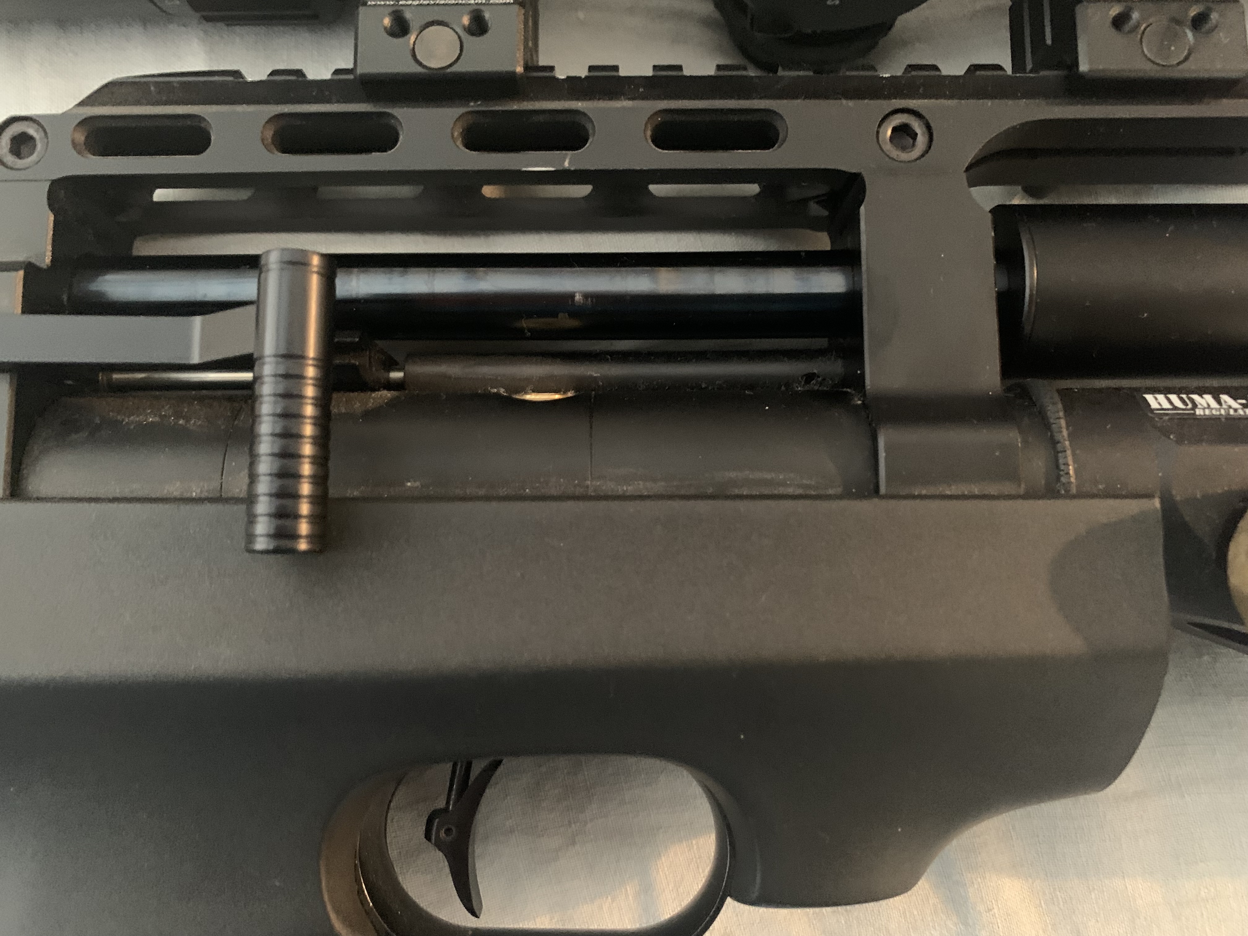

Here’s a pic showing the guts after diy conversion from tube to BT. From L to R, BT plenum, original reg section (which I think gives it a slightly larger plenum), another small plenum and then the bottle adapter.

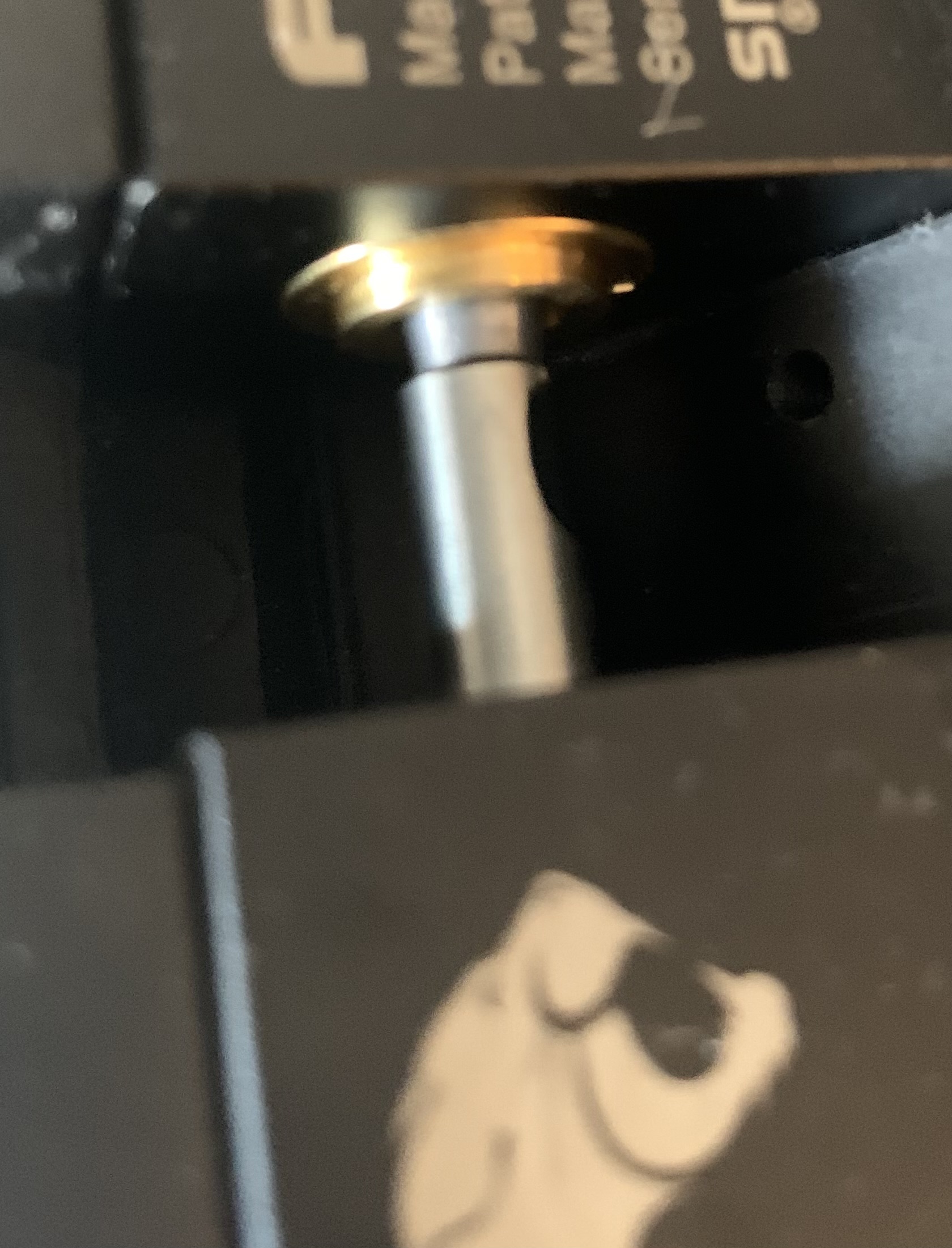

Finally, a pic of the pellet probe keyed into the base of an Altaros slug. I suspect this plays a role in the exceptional accuracy of these slugs.

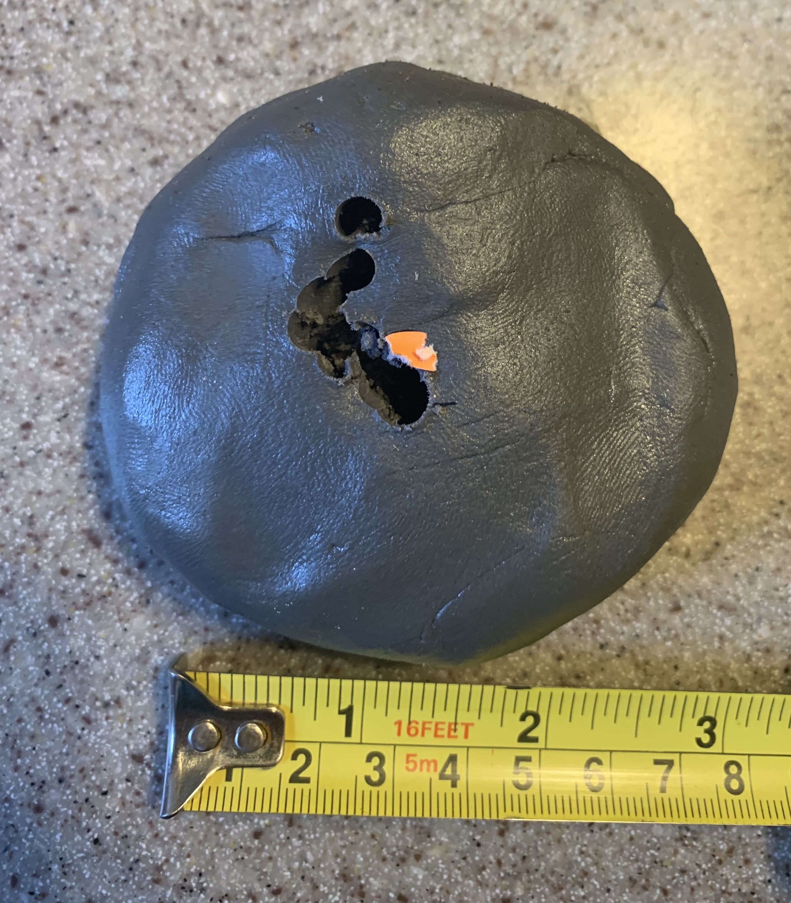

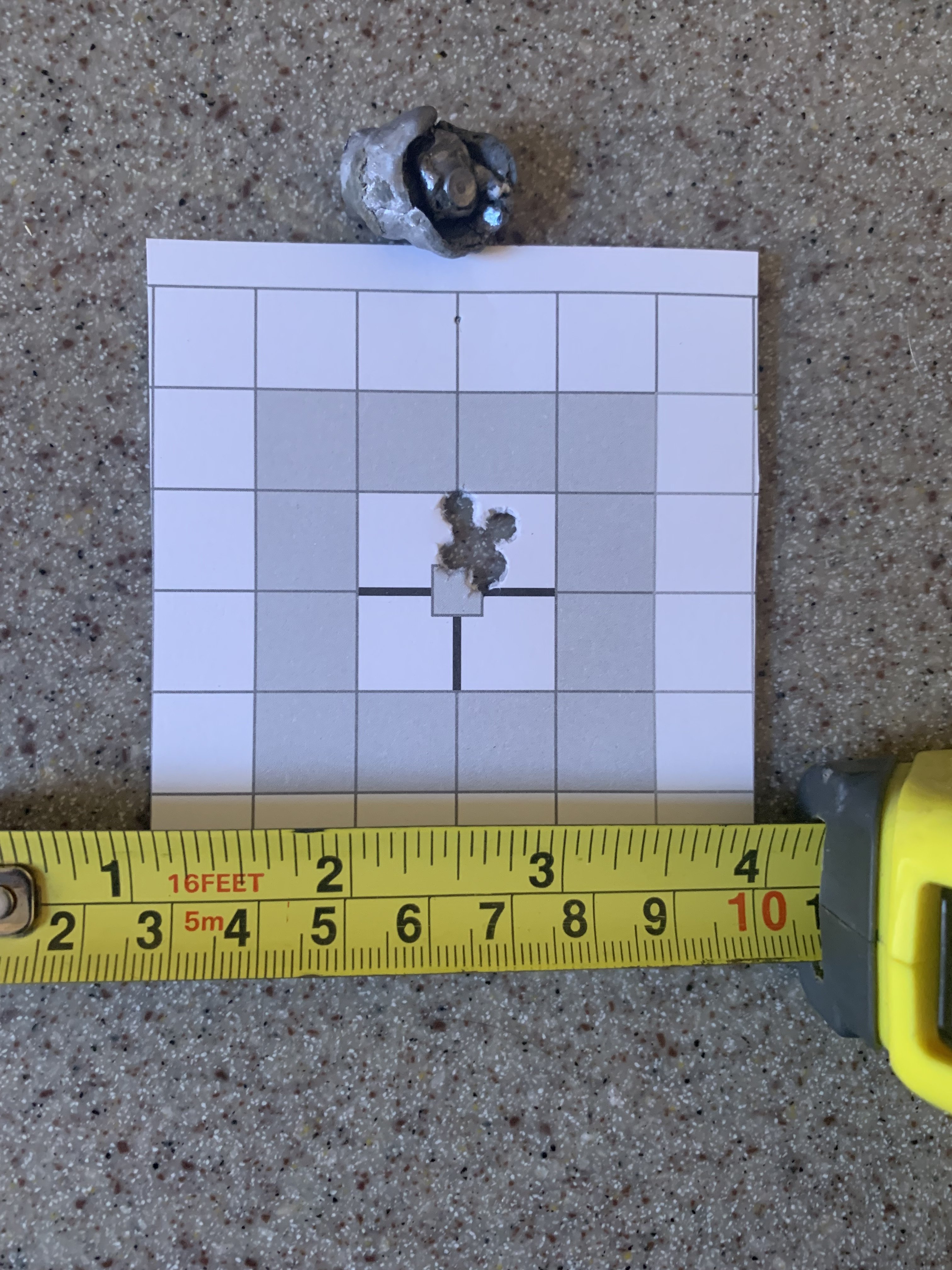

Relatively warm and very calm this AM, so I stretched to 80 with a duct seal block stuck on a tree. Same slugs and settings, shot from bags with an Element Titan at 18X. Chairgun was close with a 6MOA correction.
0.9ā€ CTC. I’m not a benchrest shooter but do have 30 years of biathlon experience. Hopefully, I can get out to 100+ at the weekend. This is the most accurate ā€œoutputā€ I’ve seen from this gun, including pellets and close/on par with what I get from the Panthera 600 shooting the same slugs.
