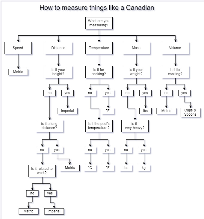

The Canadians got it even worse!
They sat right between two chairs.
