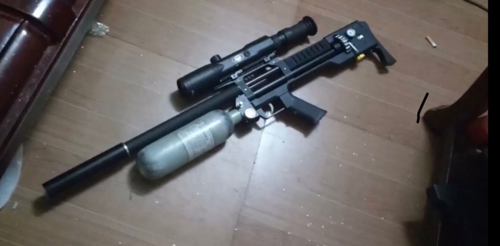

Here is a interesting .223 build but it is a Huben - Impact clone and it does full auto

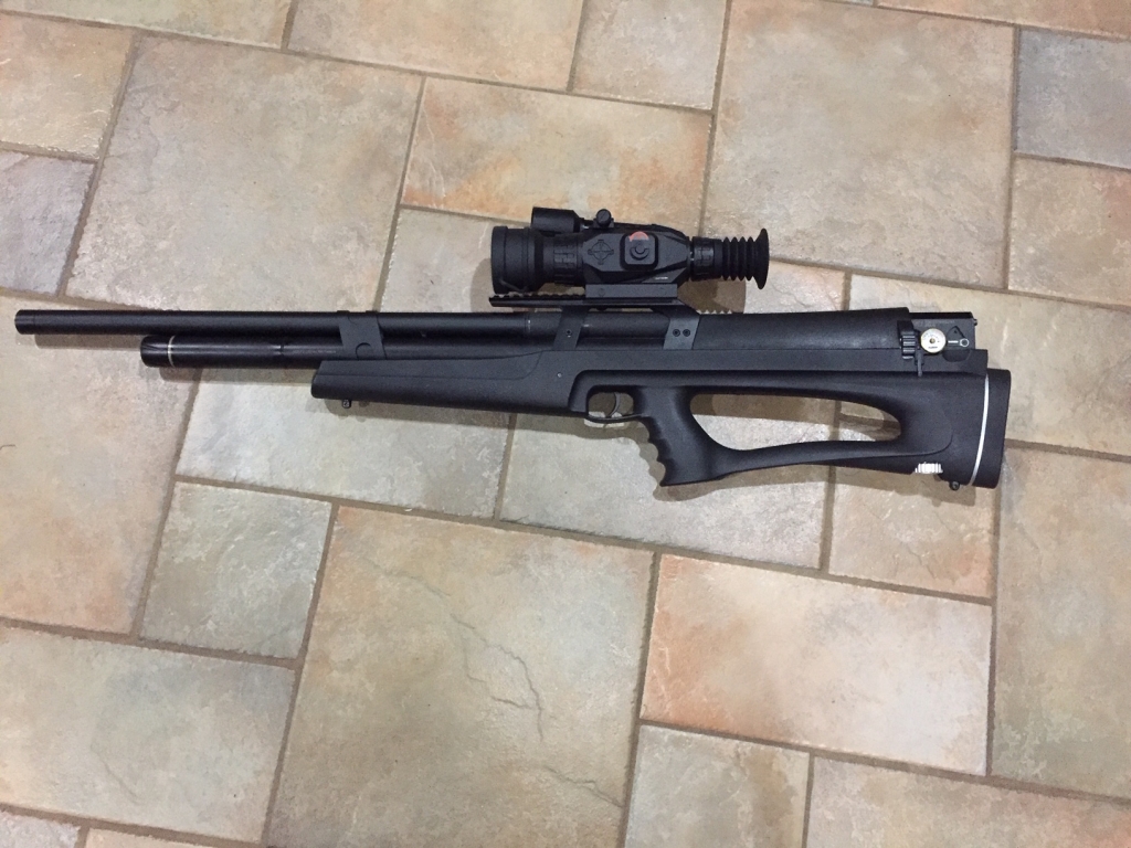

Here is a .224 Huben K1-V1 with a TJ's 28" inch long .224 barrel as you can see
the barrel is longer and the air tube has been extended.

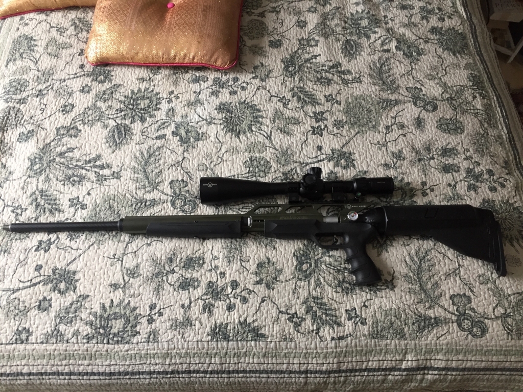

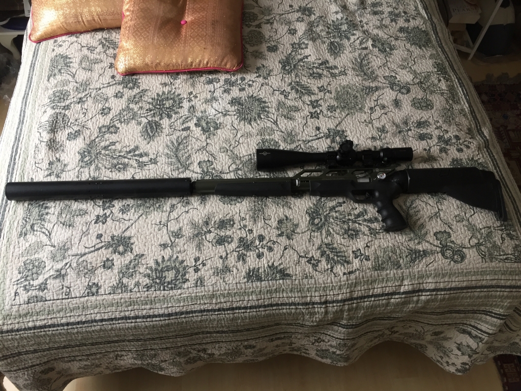

Just a few photo’s regarding my Kral Puncher One 224 cal build.
Barrel is a TJ 1:14 twist sleeved with a OD 16 mm a carbon fibre tube.
I cast FN and HP slugs, the HP are by far the most accurate and are outstanding for shooting pigeons. I have seen 1020 fps using a 47 gr FN through the chronograph that’s over 100 fpe.
Some typical accuracy photo’s, I recently stiffened the barrel with a OD 20 mm carbon fibre tube over the OD 16 mm tube. Went on a pigeon shoot then lockdown, so I haven’t had a chance to see if there has been an improvement in accuracy.
If feel if the air rifle was regulated it would shoot sub 2” groupings at 225m. So after lockdown I am going to modify my Puncher One as above with a 300 bar Priest bottle and 195 bar human reg.
Hi Mercado, I initially purchased a 30” Long barrel and then purchased the air rifle. It became apparent that the air rifle with a 30” barrel wouldn’t fit in its gun
case, so I decided to reduce the barrel length to 27.3” ( 695 mm). I removed the choke from the barrel as it doesn’t make sense to me to have a choke in a slug shooting air rifle.
Regarding the valve, yes I opened the throat from 4 to 4.5 mm and I filed the two transfer ports. In the photo you will see that I changed the flow direction as it doesn’t make sense to make air turn 90 degrees for no reason.
