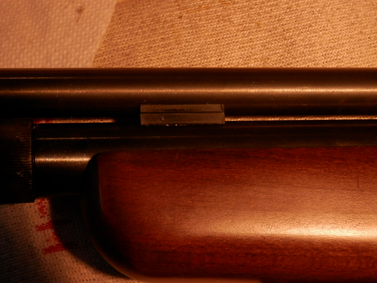

Something you might also look at is the barrel band. I've had the kind of shifts that you're experiencing and it was from the gun being bumped into by one of the dogs. Loosening the band, re-centering the barrel and then re-tightening the band cured it. I eventually removed the barrel band and placed a shim between it and the tube. That cured the problem and also improved accuracy a small amount. 0.21" groups at ten yards with .22 CPHPs are now the norm.
The barrels on these guns are only secured by the barrel band, the allen-head grub-screw on the receiver and the o-rings around it in the receiver. Drilling and tapping holes for a couple more in the sides of the receiver would reinforce things some. I plan to do that on mine soon.
