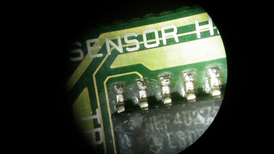

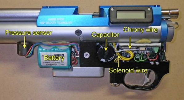

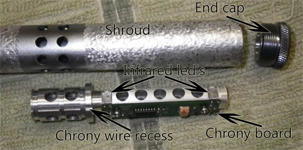

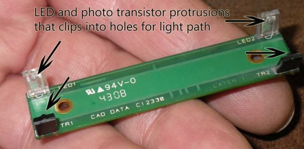

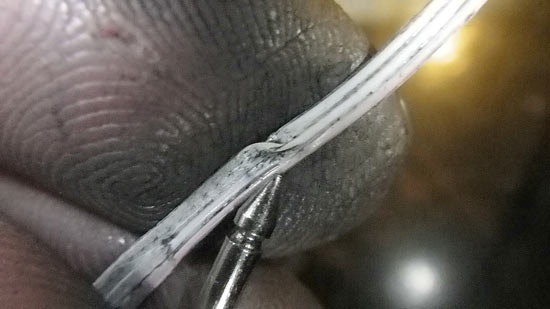

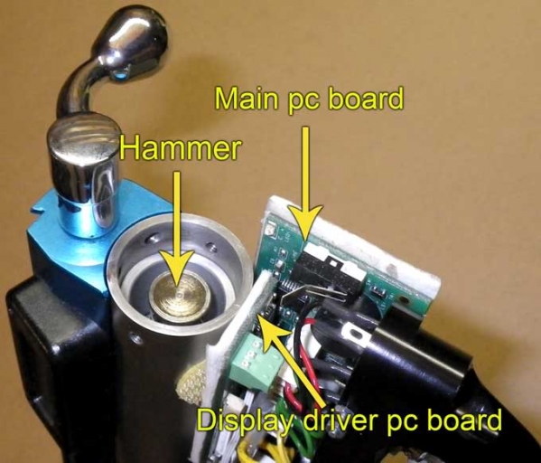

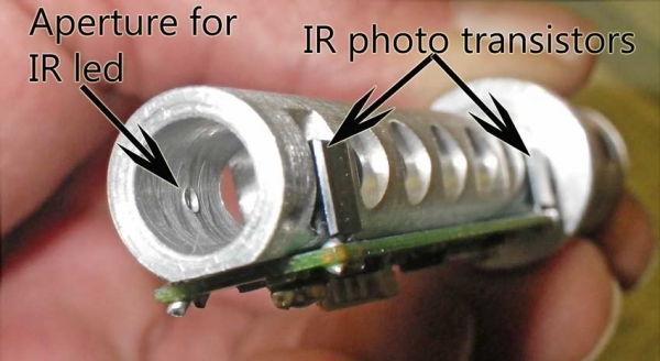

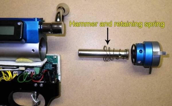

From 2010 Hiccups start ! http://www.straightshooterschat.com/showthread.php/318-Daystate-Grand-Prix
Pictures from 2011 here: https://www.airrifle.co.za/threads/18335-The-Daystate-electronic-air-rifles-de-mystified-Review
...was never a fan of electronics as already mentioned...would the gun stand the test of time ? ..and how do you self service them ? and what about parts ? or if the company no longer has the parts or goes defunct ? ...do I need an electrical engineering degree simply to tinker on them ? These pics are an eye opener..and am still mystified as much as the author wants to "demystify" the electronics...
