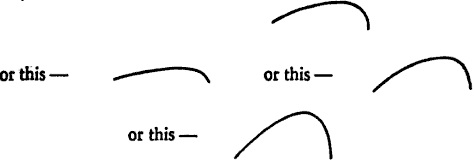

I think Stoti’s reference to the flatter trajectory is the picture one should imagine. Instead of an asymmetrical parabola, the steeper the angle the more symmetrical that parabola is. You will still have the same drag forces in place and effecting the projectile, though the parabola shape of the flight pattern has been altered based on you initial starting frame+angle.
Maybe that doesn’t make sense but between breakfast and diapers that is the best your getting from this guy. That drawing is from “The Naked and the Dead” by Norman Mailer. Random, I know, but I grabbed it since I knew the drawing well. Your horizontal flight drag is getting increasing amounts of vertical flight drag. This reduces the need for vertical holdover on your scope.

Because you are not shooting perfectly straight down the y axis but rather a degree horizontally along some form of a triangle like an asymmetrical parabola. Your holdover is less than it would be shooting a trajectory along the x axis, but there is still the gravitational force at play. It makes your holdover placement as though the object is closer to you. If you look at my other post above with the drawing of the asymmetrical parabola, imagine if they were tilted on an 45 degree angle down; in such an example you can imagine your point of impact being somewhere in the middle of that curve before gravity has its way.

Maybe think of it like this-if you shoot a pellet off the edge of the grand canyon you could hit the river below. Gravity pulls the pellet down but it started on a downward angle so it follows a relatively more "straight" path downward with gravity curving it downward relatively less. And in that case gravity wouldn't be "slowing it" much at all, if any. More like the left arc of the 4 drawn above. But then if you stand at the river below and shoot upward toward the cliff edge the pellet would be slowed (moving more against gravity) and ultimately curved relatively more by gravity. It would never be able to reach the cliff above, not enough energy present to overcome the gravity. More like the bottom arc of the 4 above.
