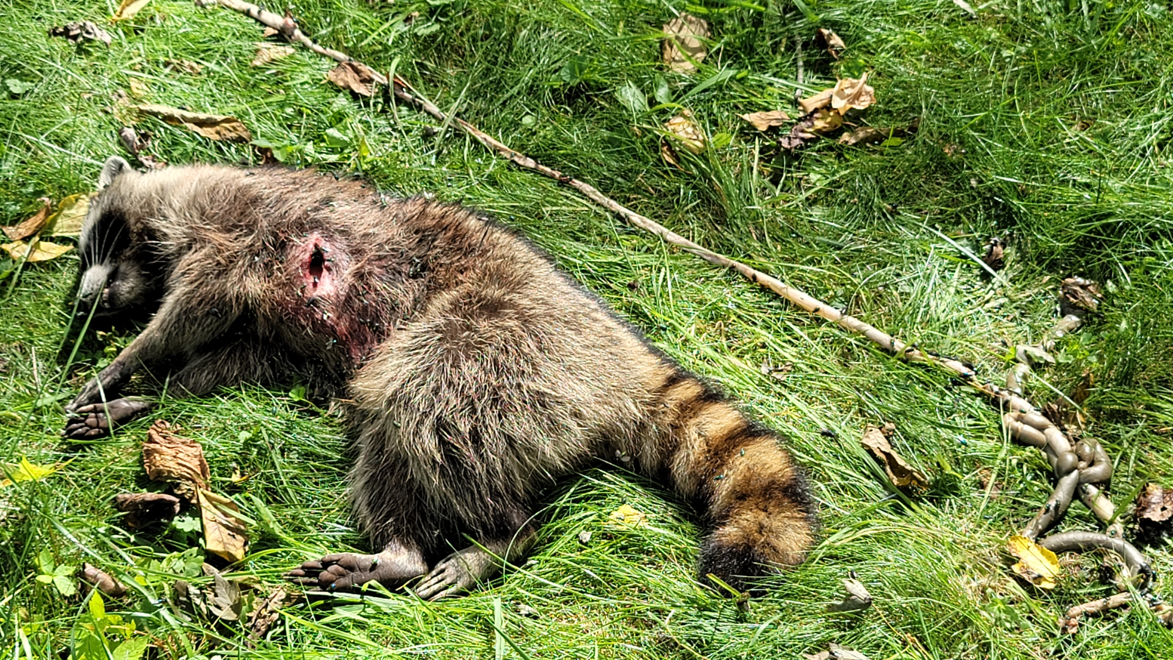

Lol, no kidding. Looks like you shot it with a AR-15.
Damn, now that's a hole!
NSA 110gr from Benjamin Bulldog .357 at around 25 yards. The hole wasn't that big from the shot. I think a possum got to it and ripped out the intestines, which made the entrance hole bigger.
