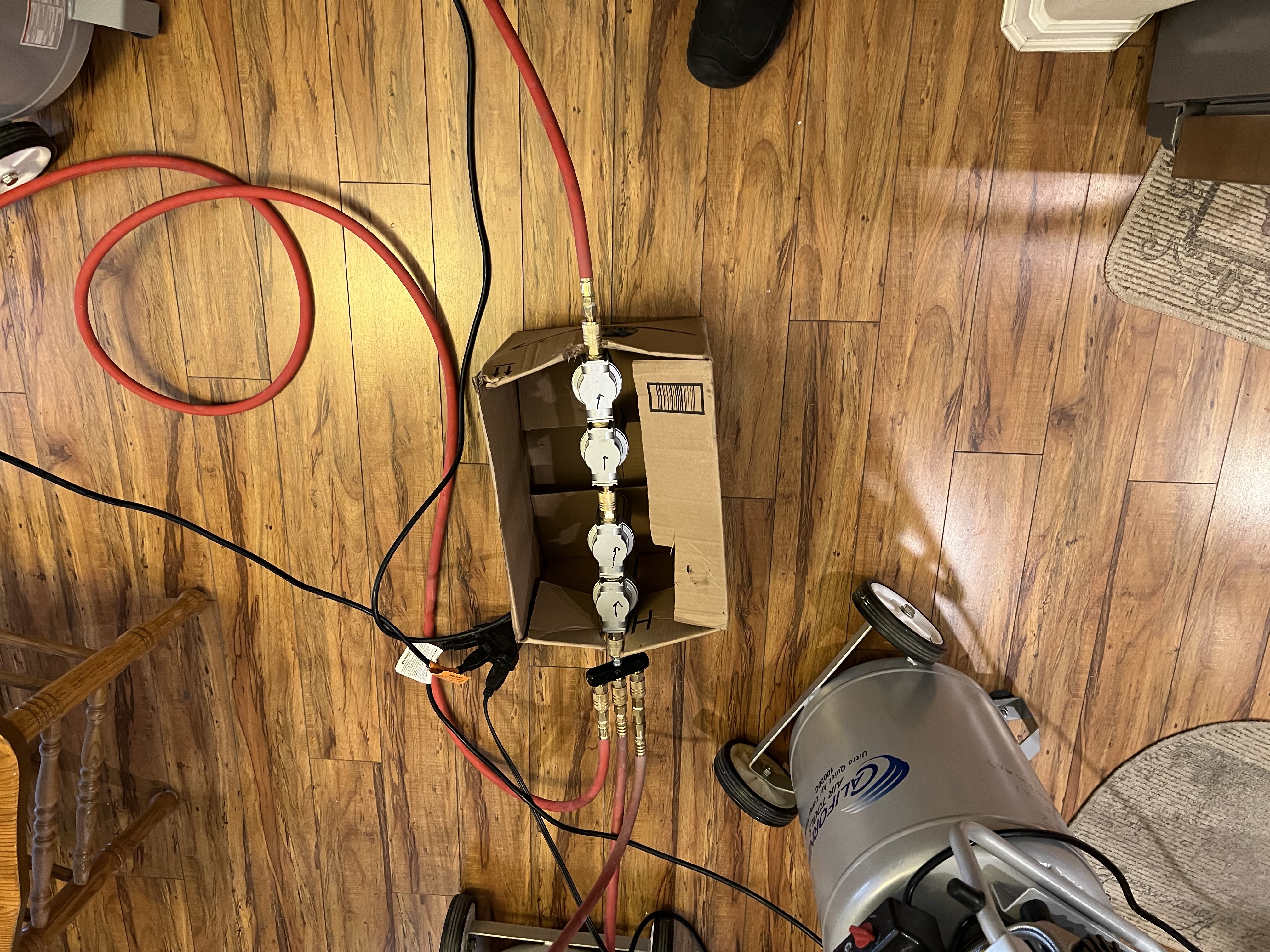

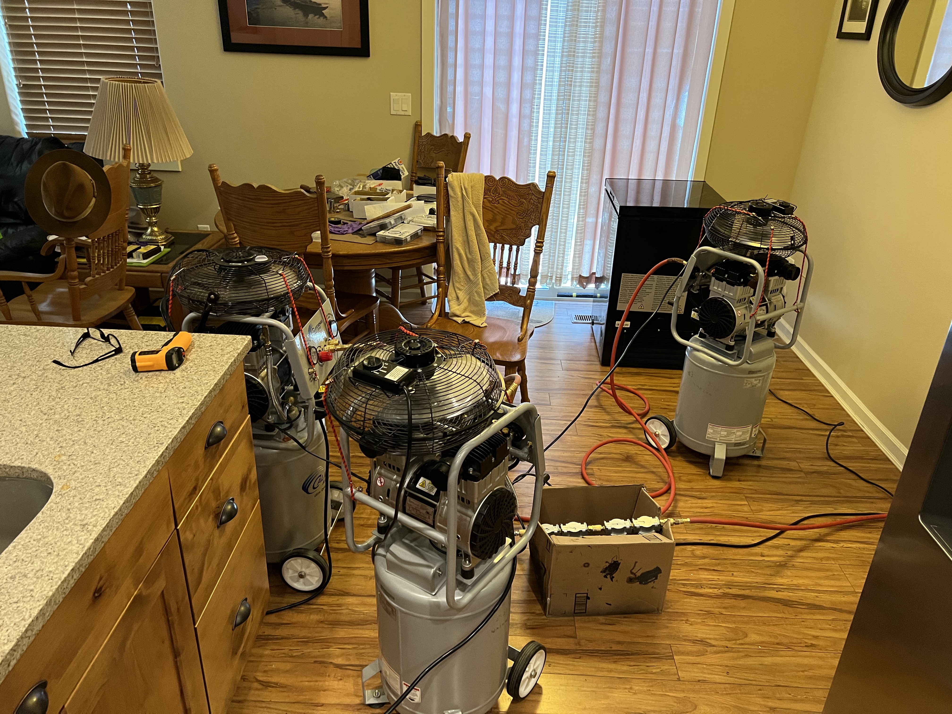

I live in the high desert, we get down in the teens in humidity. I use a Altaros booster powered and supplied from 3 CAT oil less compressors that I filter through 4 exterior dessicant filters and a final and 5th dessicant filter inside the Altaros cabinet. I do not use a water and oil trap type as my 3 shop compressors are oil less. Oddly enough I actually add some silicone oil to the Altaros booster now and then.
After filling my bottle, I breakdown the system, empty the dessicant material and replace it with dry material.
The air hose between the 3 shop compressors and the first 4 dessicant filters will have water dripping from it, even when the humitity is 15 to 20%.
On the filtered side with a 2 hour run, there is zero water, to the point that the water filter in the Altaros cabinet has never needed changing.
Point here, we make water compressing air, even in dry environments.
Now I have run my system with one, two and three CAT, Californiaairtooils, compressors They individually put out about 5.2 cfm at 140 psi I have them running at. As I added compressors to the system, my water manufacturing volume dropped. More compressors means less work for the individual compressor and less heat, and there in us the golden rule of pcp compressors, HEAT IS THE ENEMY OF AIR COMPESSORS.
I also modded each compressor by strapping a 12 inch modified floor fan to the top of each one, those CATS love those fans, as did the tech guys at CAT.
I used to have the system in my garage, but adding the third compressor meant that I ran out of dedicated electrical lines so I moved it all into the Kitchen where I had three 110 lines.
