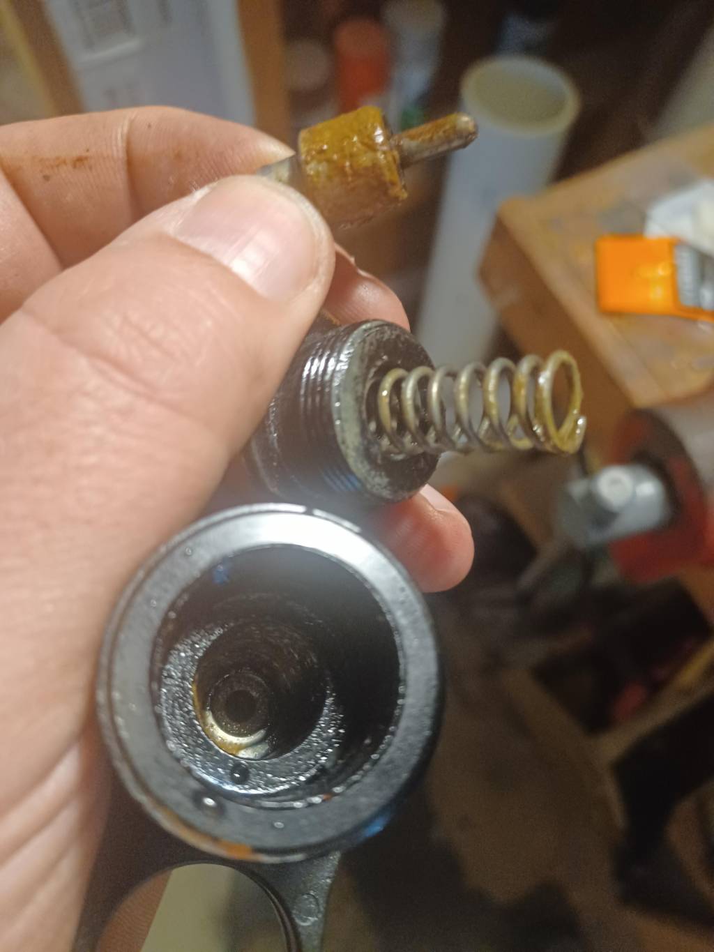

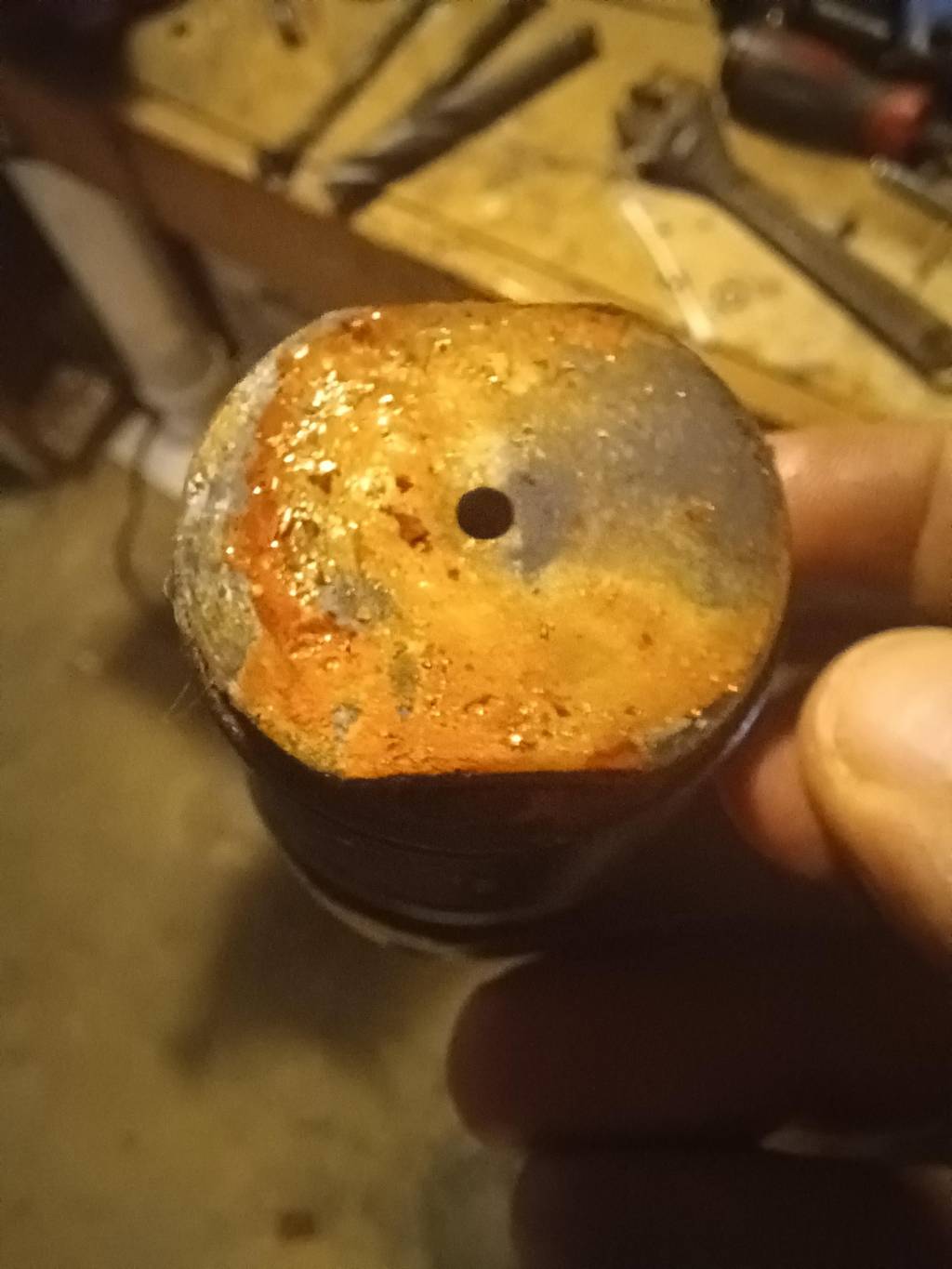

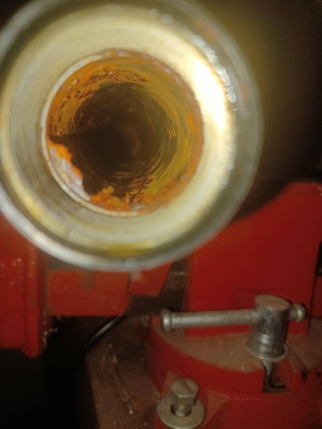

Customer gun. 5 years old. He couldn't belive that I found this and and why I couldn't finish the tune. Blamed me somehow. This is why customer tunes are so stressful.

Pardon my ignorance but is the gun salvageable? Can that be fixed?
Partially salvageable. The valve was rusted to the tube and the amount of heat and leverage needed to break it loose damaged the valve a little. Not sure how bad the tube pitting is but it could affect the safety of high pressure. I'll end up finding new parts to rebuild it to be safe.
