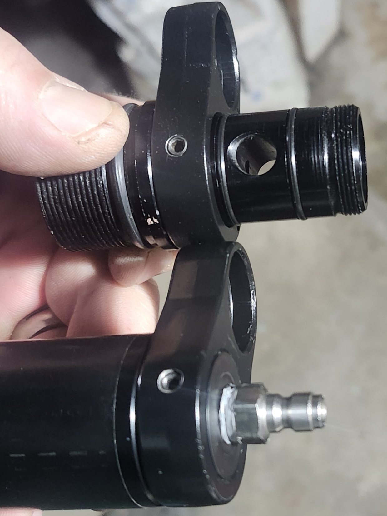

Cut the front off the fill assembly. Used Birchwood Casey Aluminum Black to refinish. Then drilled and tapped for 1/8 BSPT. NO MORE PROBES

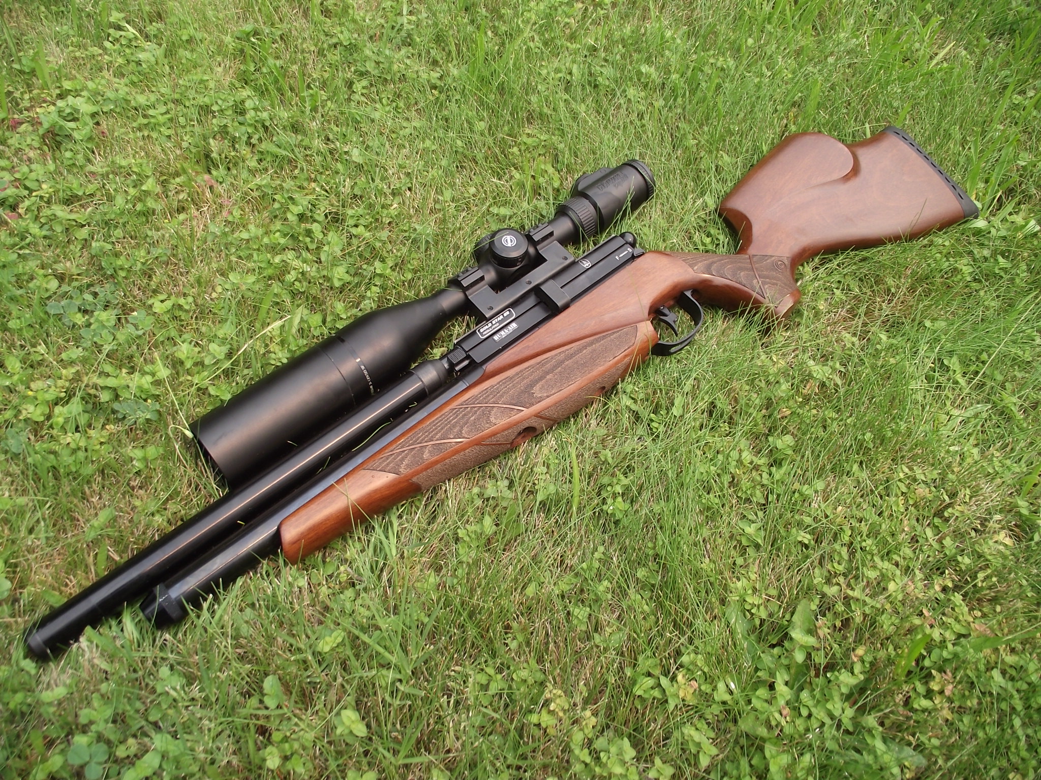

I’ve got a BSA Goldstar SE that could use some of that love, and a Brocock Atomic.Cut the front off the fill assembly. Used Birchwood Casey Aluminum Black to refinish. Then drilled and tapped for 1/8 BSPT. NO MORE PROBES

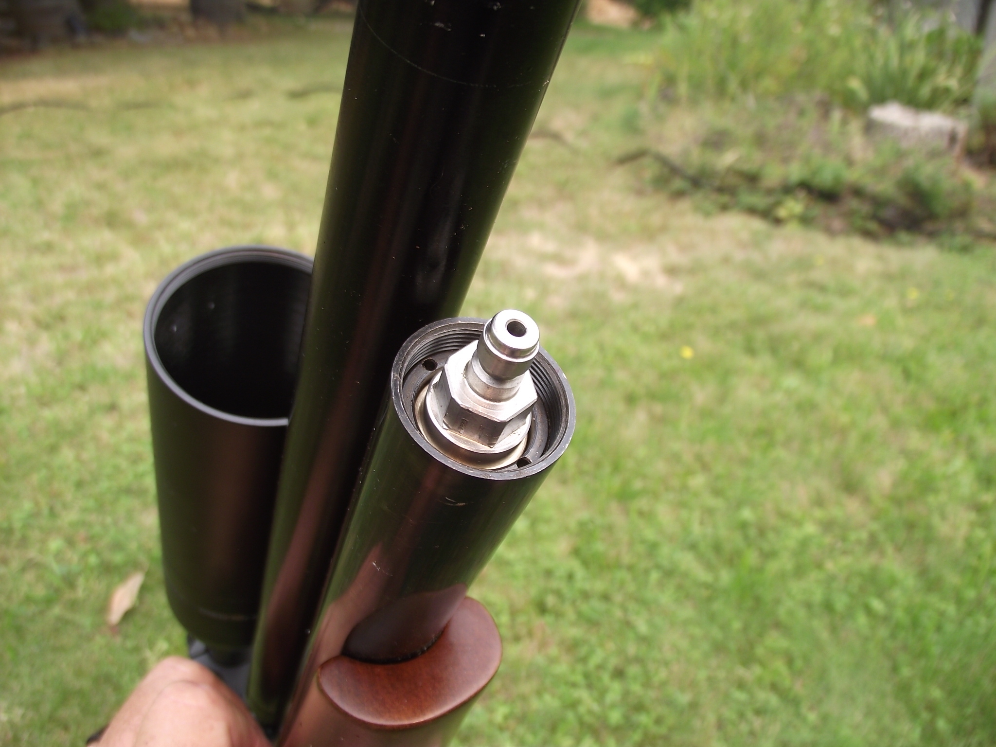

Only the a few Kral have the gauge in the front so you'd have to relocate that to the valve which isn't crazy difficult and would make it so much nicer than looking down the barrel while you fill.I’ve got a BSA Goldstar SE that could use some of that love, and a Brocock Atomic.

@RabbitofCaerbannogCut the front off the fill assembly. Used Birchwood Casey Aluminum Black to refinish. Then drilled and tapped for 1/8 BSPT. NO MORE PROBES

On the BSA the factory hide filler cap still screws onEhh I prefer the probe. More streamlined look. I don't really like the front facing fill nipple
Being a bit slow on returning to my ol friend the BSA Goldstar SEDid similar a few years ago on a BSA Goldstar ... Agree on the dislike of probes !!!
