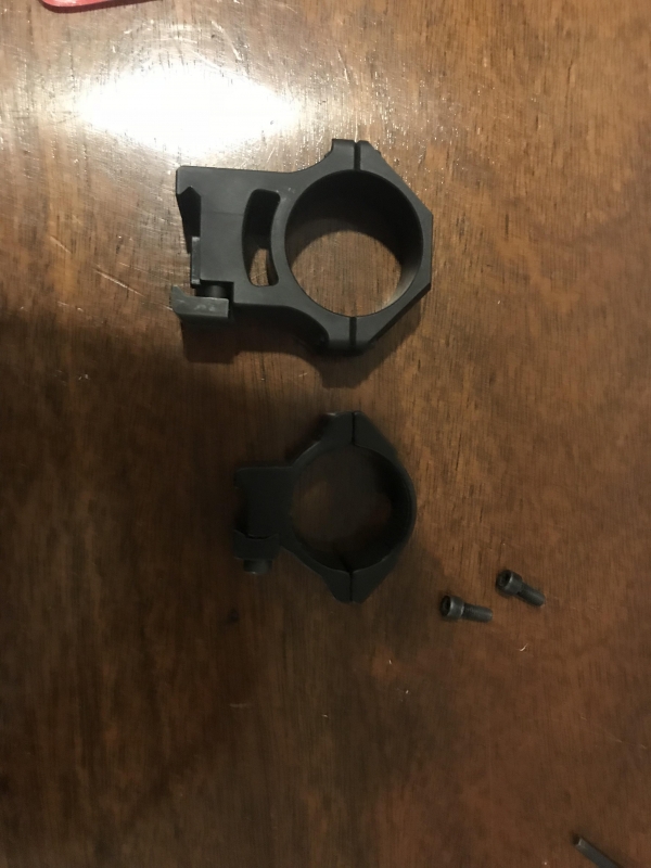

1540251594_20060440365bce5fca0d2db5.75398100_130AC448-1A51-4733-B194-00DA37175185.jpeg
I thought this photo would be an nice comparison between 30mm and 34mm. You guys now should understand the possible weight differences hahah. Hey though my 34mm scope seems like i can zoom in and see the squirrels soul though :) or perhaps shoot at the bacteria on them.
