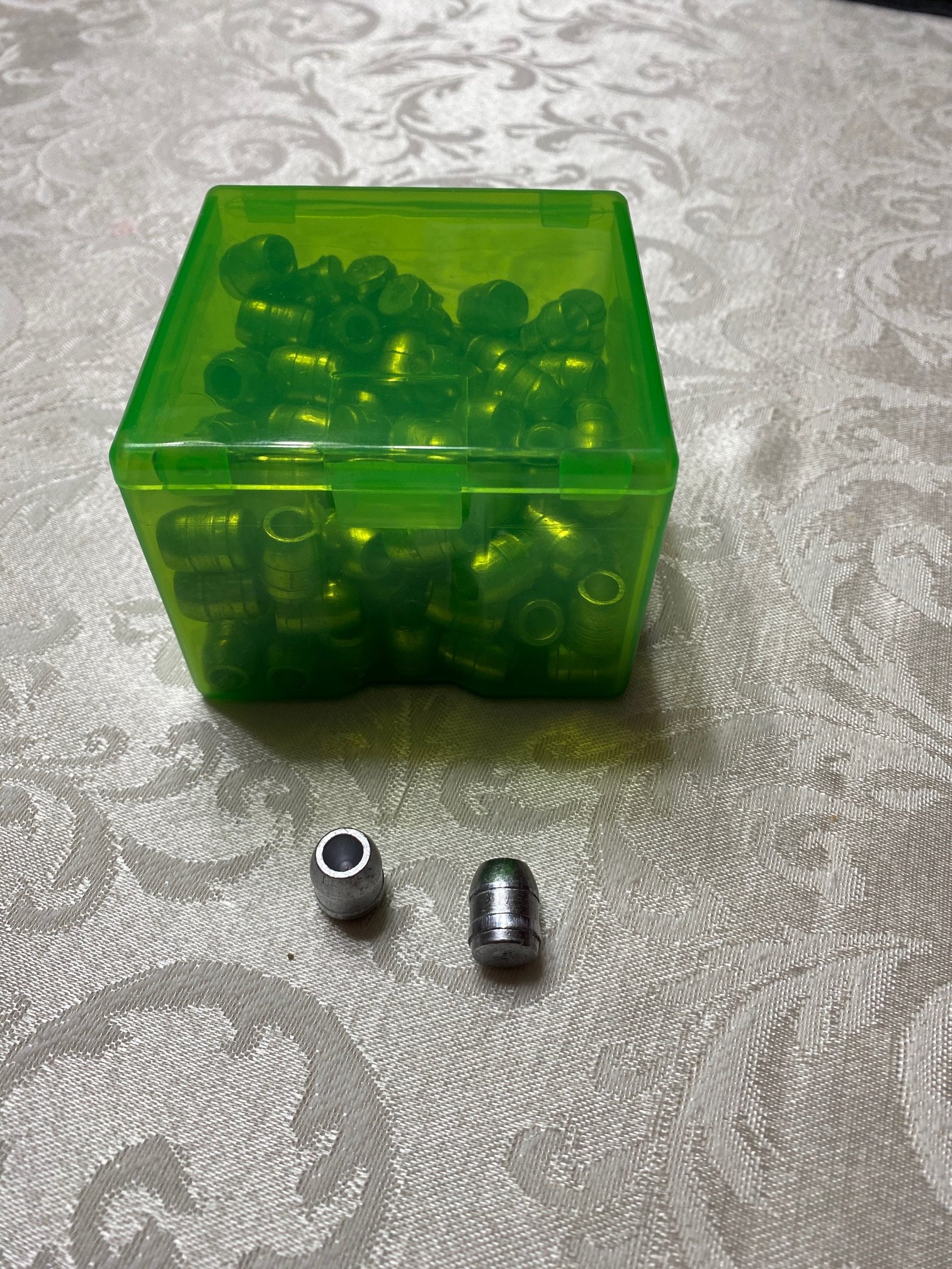

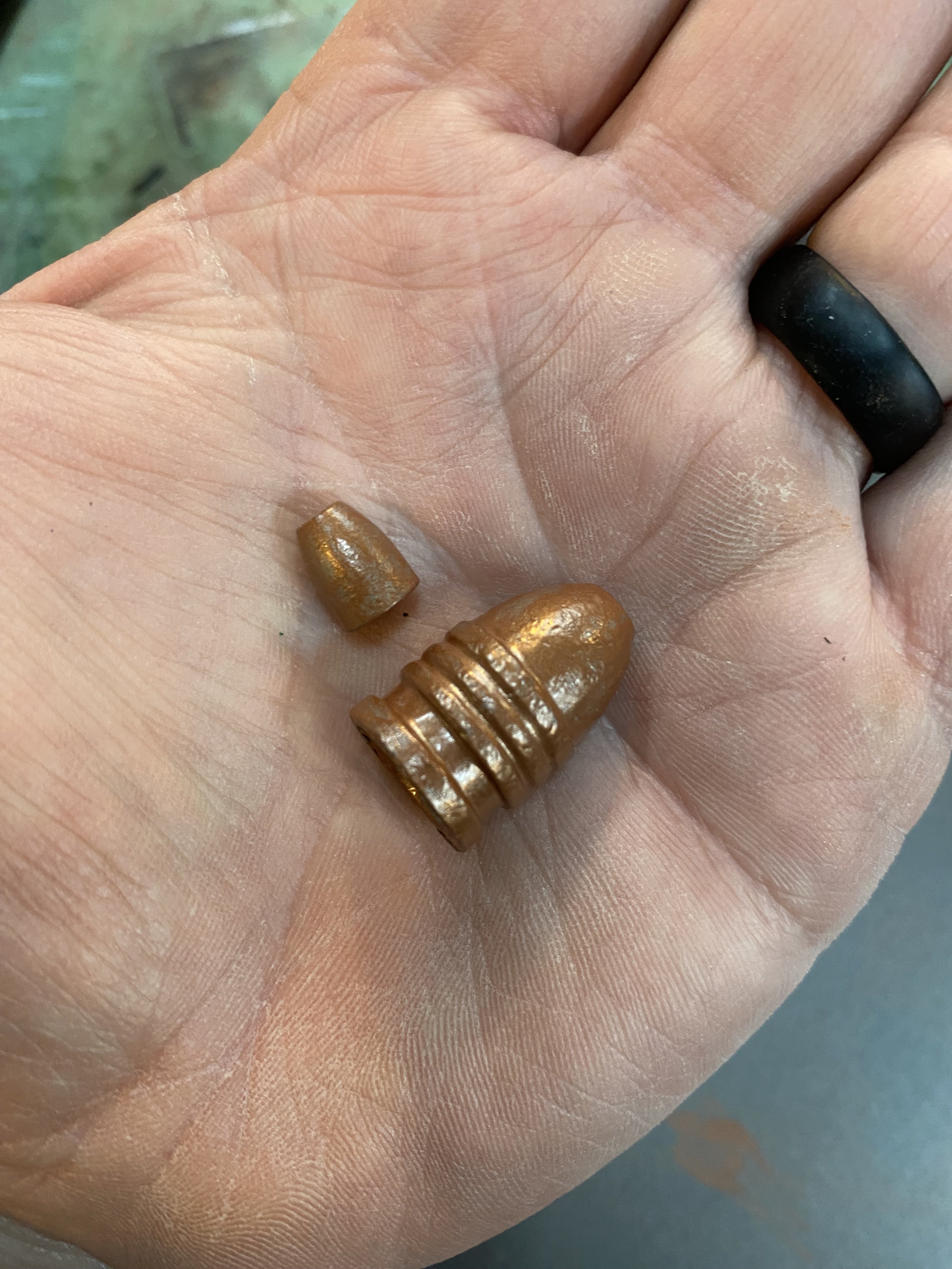

Fresh cast and sized to .457....NOE 458-244 four cavity mold.

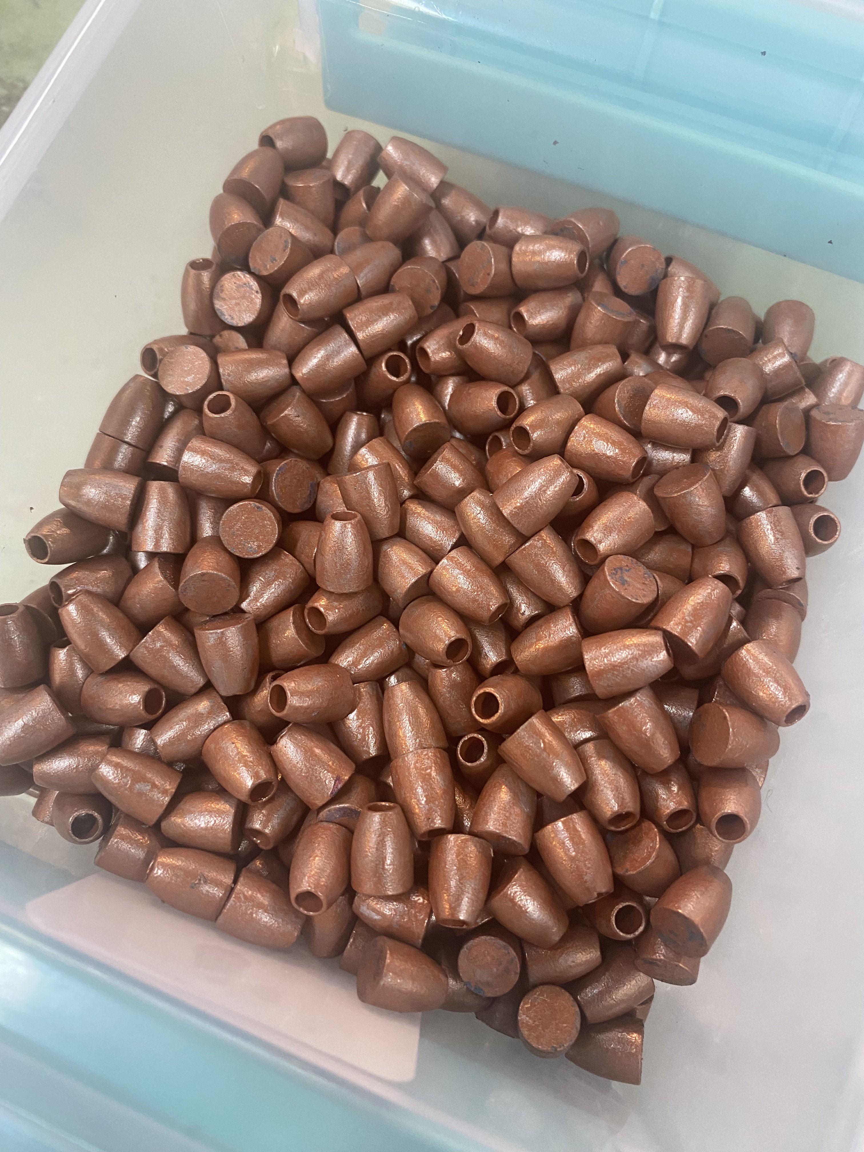

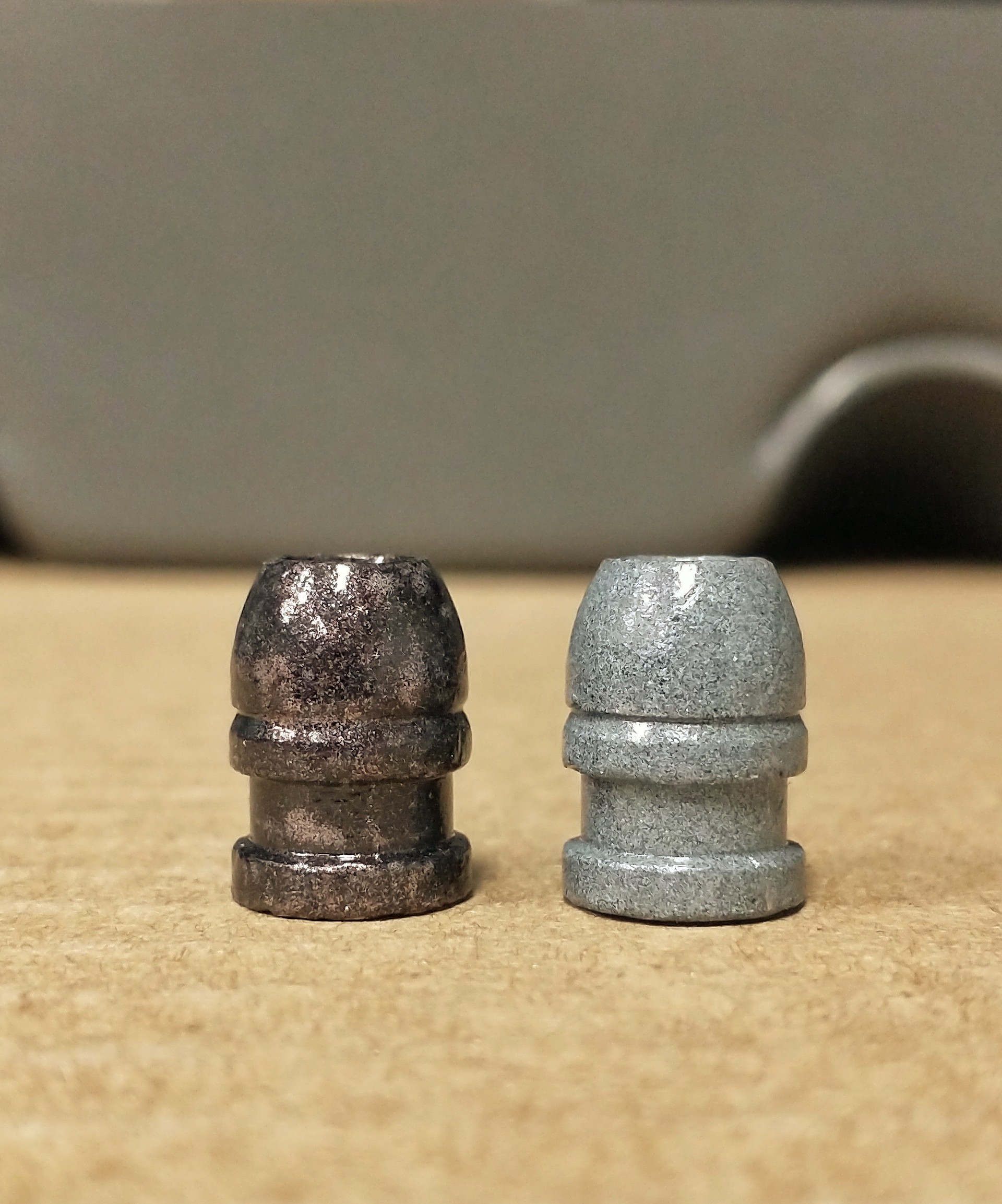

I've got a bottle of Eastwood Copper Vein that I don't really care for. It looks good mixed with other colors though. The one on the left is Copper Vein and the right is Copper Vein mixed with Cardinal Hammer White.
How much power coating buildup is added to a sized slug? .001, .002, etc?

Are those out of NOE 460-315-RFAV3 mold?
They look good!
Yes that is the mold I have the double cavity mold they shoot great in my Texan and I had planned on sizing them down to .454 to shoot in my XP Ranger just never got around to doing it. I cast these the other day and coated them to shoot out of a Quackenbush Outlaw 457 that Bob Dean had tuned just waited on the weather to get better to try them.

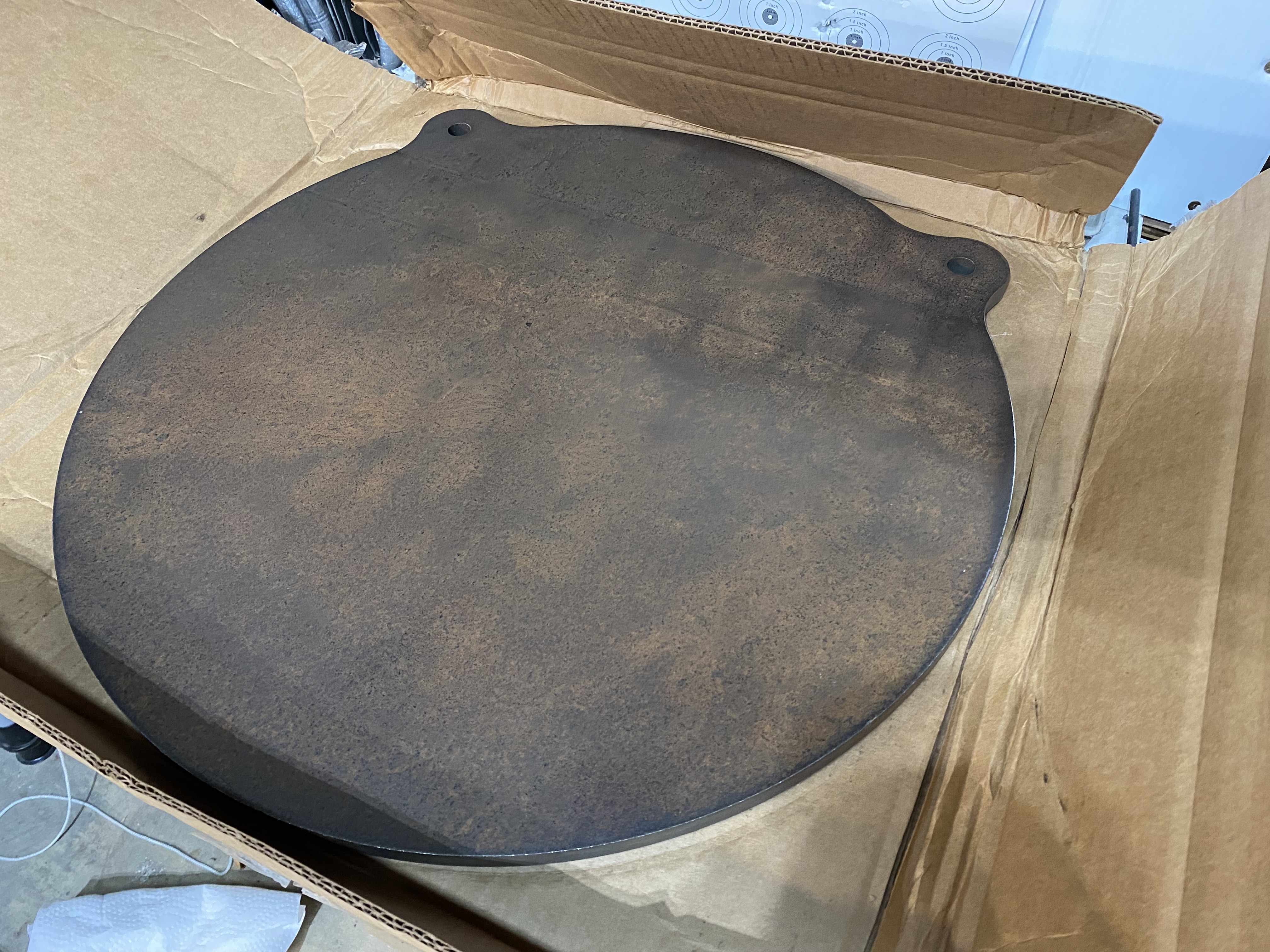

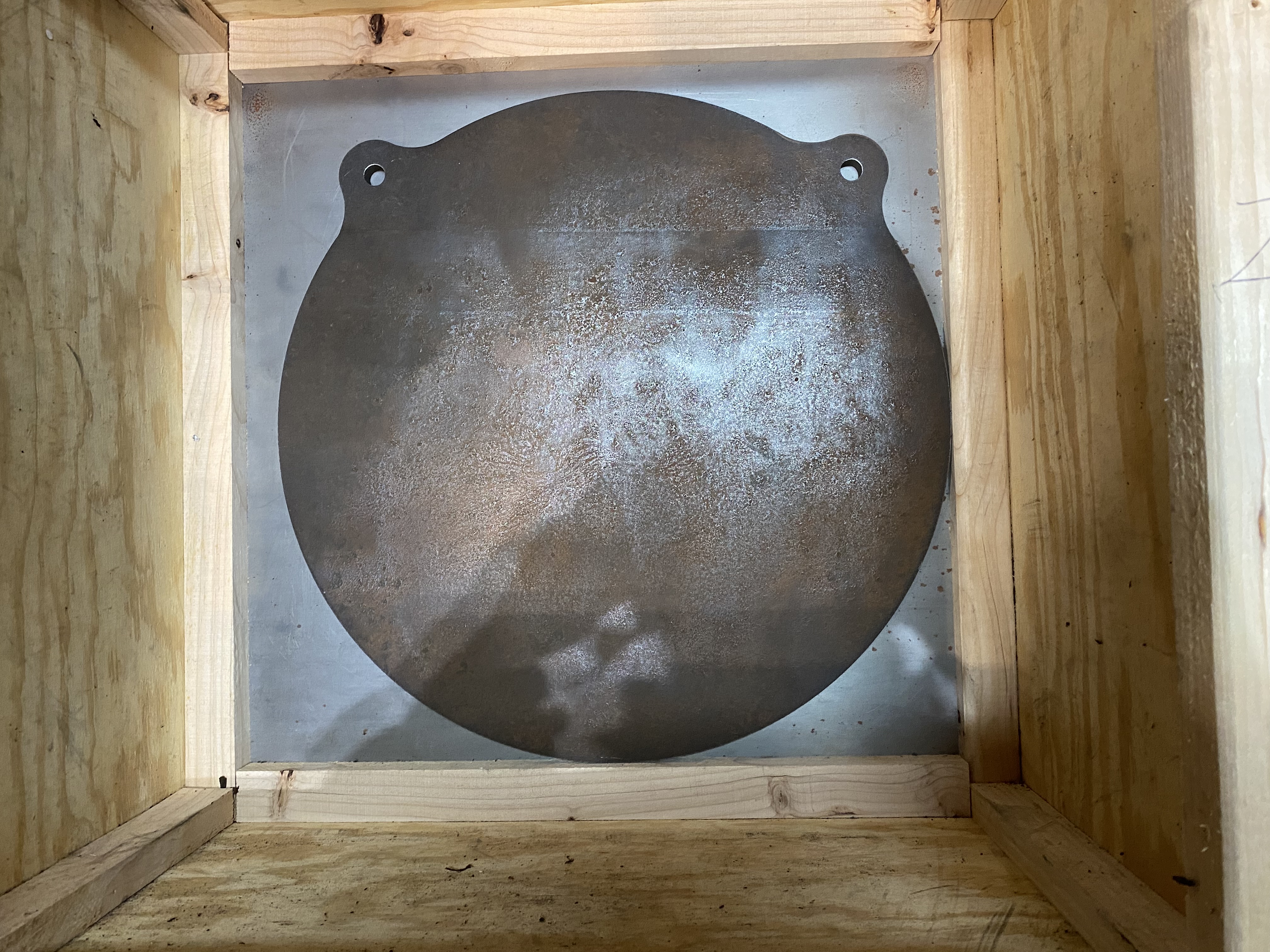

Cleaned the trap so I could install this big boy in the back of the box. A 20" x 1/2" AR500 gong. Something a for a little extra to insure stopping the .58 Cal from the Zeus. Box is 24" square x 12" deep filled with rubber mulch. It has stopped .457 Texan but it is driving slugs near the rear.
The box is filled
@Loren I angle all the AR500 plates in my indoor boxes and have to put a plate on the bottom as well - not sure how ricochets will work with the plate verticl
The box is packed full of rubber mulch. The projectile should be pretty slow by the time it hits the AR500 plate if it even reaches it and the mulch would also take up any ricochet energy.

The box is filled
That's true, I forget that I only burry my plate about 2" deep so the mulch doesn't absorb much but I still get the satisfying sound of the steel.

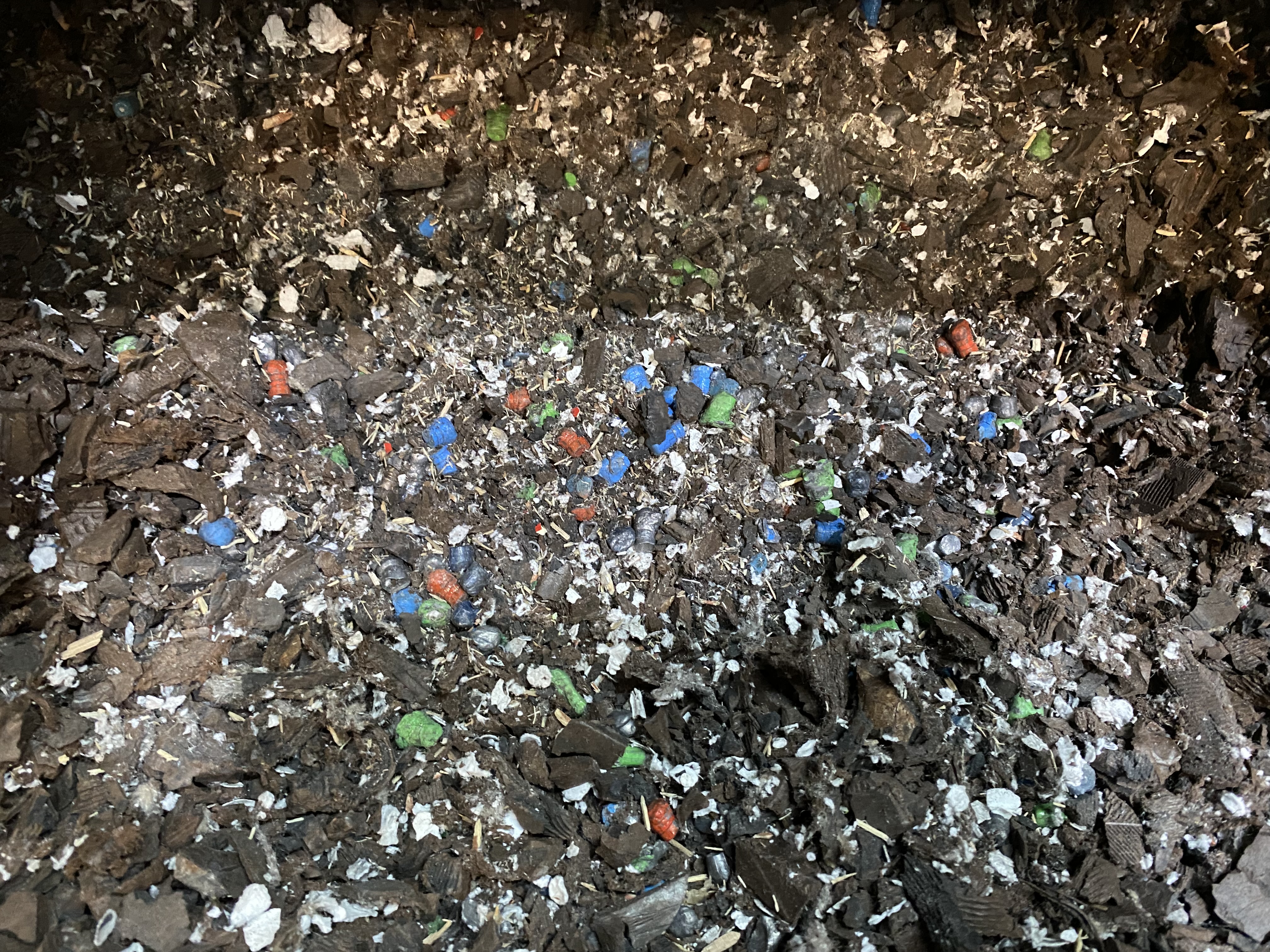

Here is all the lead from the trap.
It is nearly 30 lbs.
I only do melting of this lead outside or on my industrial spray booth bench with a 12" exhaust duct which is sucking 100% of the fumes/ smoke outside.
If any rubber is left it STINKS... it is basically shredded tires and the PC is nothing you want in your lungs either. The PC is most of the time a polyester resin, so think of a burning leisure suit...lol
I hand sift through the mulch while using a large shop vac with a cyclone separator on it to drop out the mulch and let the very small fines go into the vacuum canister.
The bright PC colors really help with the sifting. It is tedious but it works and is not real messy.
I tried the water separation once and it was a FAIL. The rubber is dense and not all of it floats so I still ended up hand sifting and now everything is wet and a mess.
