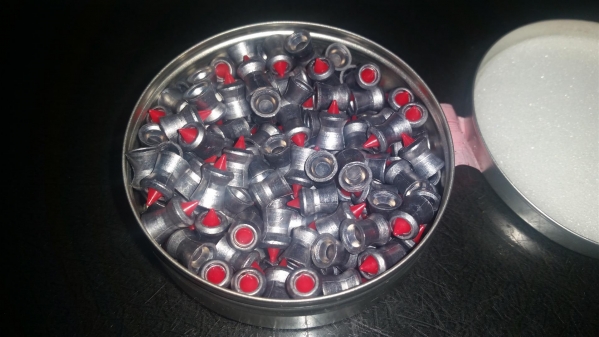

Who shoots Polymag pellets, or wants to, can't because they don't fit the mag?
I'm making up some parts so I can put polymags in my S510, Streamline and Impact because hand feeding the beast one at a time isn't fun.
Seems like they would be a great hunting round. I see some peeps saying they make a good general purpose round too.
Who likes these pellets? And who doesn't shoot them because they won't fit the magazine?
