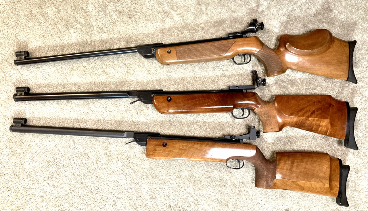

+ Photo top to bottom: LG 55T, early LGV Olympia, early LGV Spezial. All three have a 15mm diameter barrel; the 55 wears a 19mm sleeve, and the LGV's a massive 23.5mm one. Note the different diopter sights: well-known rounded pattern on the 55; upgrade steel one on the LGVO; later alloy model on the LGVS.

Drop dead gorgeous right there! What I would do for a LGV.
Reactions: MDriskill

Those are absolutely lovely examples, a very attractive timeline photo.
