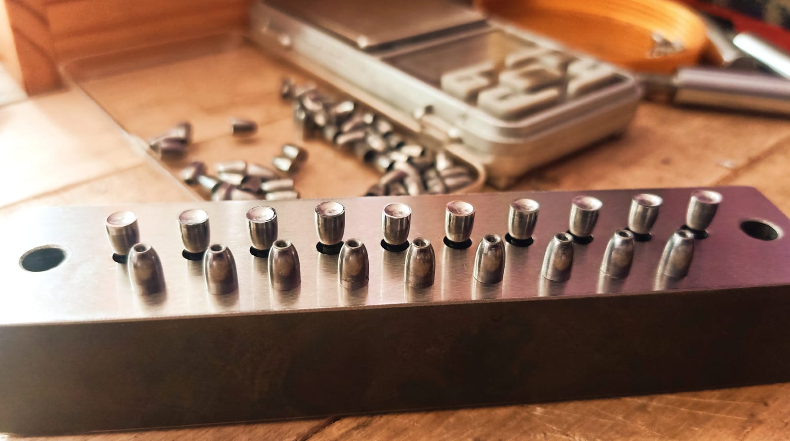

Any one used the slug mould called lanslug it is made in Indonesia.
Reactions: MrP
Google search didn't turn up any hits on this.
I suspect it's similar to the H.M. Hen swage kit, where as exporting it may be an issue.
Yes the have not official site on net. But I found a Facebook page for them and slot if YouTube videos, yes a good price for swag kit, but I want to ask if the casting mold more cheaper option give an accurate results close to pressed methods. The People used for example lane or Noe one could answer this question
