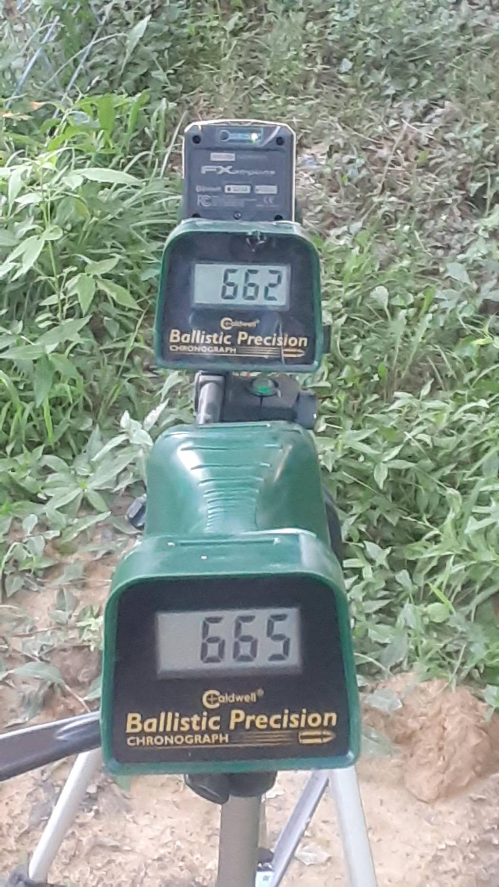

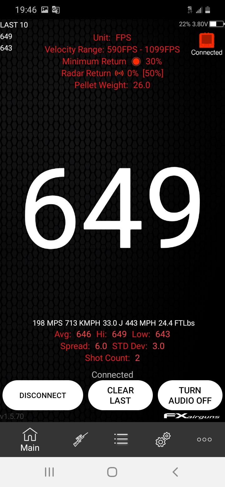

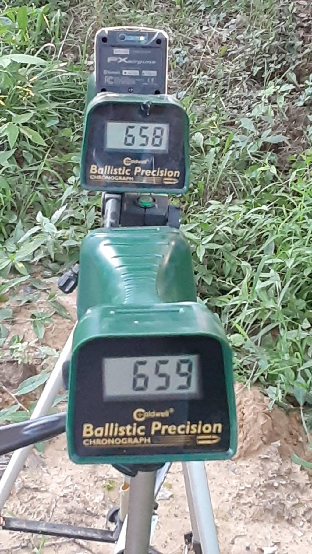

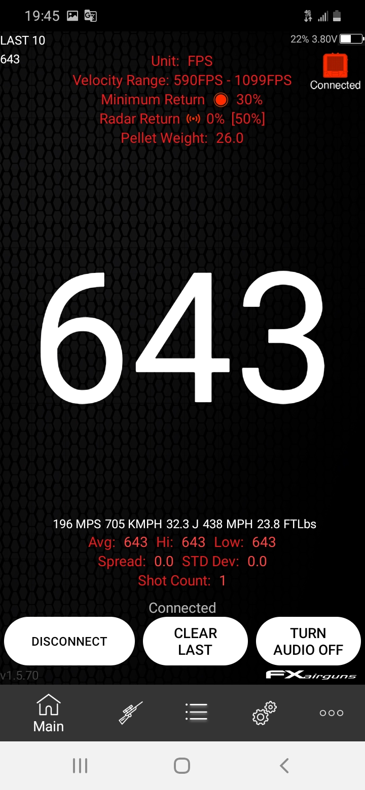

Here's two shots over 3 chrony at the same time. I am using my phone for it all so you'll see the screen shot then the pic. You'll notice the FX string shows the first shot in the upper left corner.
FX is coming in about 15fps lower every time.

Welp you are shedding velocity between chronographs.
659 -> 658 -> 643
and
665 -> 662 -> 649
The difference between the shots looks like
Chron #1 665-659 = 6
Chron #2 662-658 = 4
Chron #3 649-643 = 6
So consistent ... nobody read higher than the one before it... That's good. Each of them shows a drop from the one before it... That's good.
To be honest I'd be comfortable trusting any of them. The differences just aren't that big. Change the order of them and run the test again if you want to get an idea of how much error there really is.

The FX is strapped to the second one and the first one is touching the second. Less than 2 feet between the three.
On shot 1
Caldwell 1 = 659
Caldwell 2 =658
FX = 643
Shot 2
Caldwell 1 = 665
Caldwell 2 = 652
Fx = 649
Fx is 16fps slower than Caldwell 1 on both shots and 9-15 fps slower than Caldwell 2.

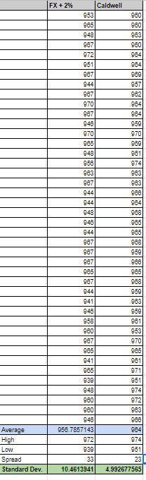

I agree that without an instrument that is known to be 100% accurate that calibration is not possible. However, the thread is definitely not nonsense. Here is a small sample of data I collected today while testing. Both samples stay pretty close to the average. However, the Caldwell is much more consistent judging by the Standard deviation of 5 vs the FX's 10.5.
Which would you trust? A gun that is consistent or one that shoots an occasional flyer/outlier? I'll go with the consistent one.
