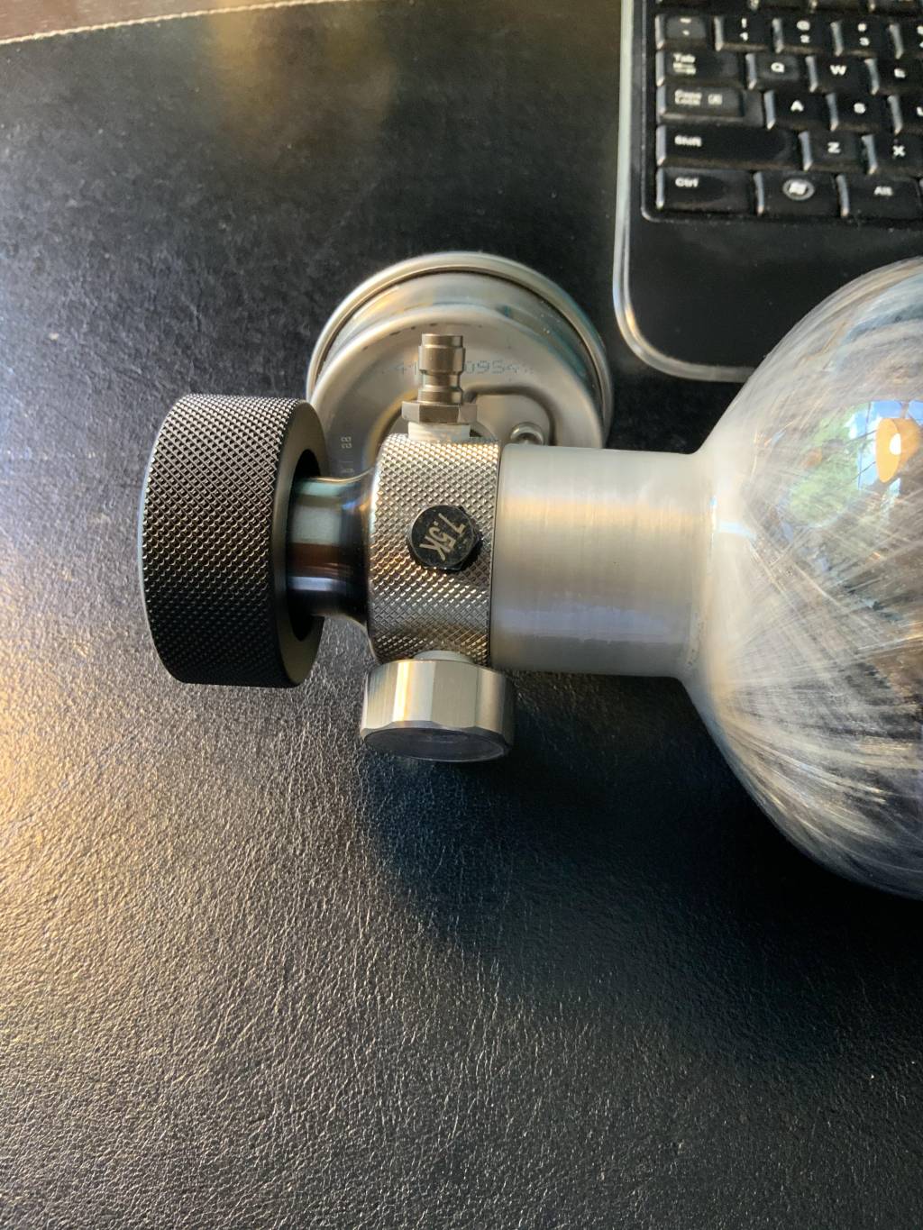

I recently was sent a small CF tank for use with my new air rifle. Unfortunately the vendor had sent a scuba valve instead of a valve for a paintball place and needed to forward me a new one. I received the new valve today and was happy... until I went to the paintball place and they refused to fill it.
Their reasoning for rejecting the tank valve system was because the valve assembly was not permanently attached to the tank..... they said that the tank was dangerous and should not be used. Now, the question is, other than just screwing the valve assembly onto the CF tank by hand, is there anything else that needs to be done?

If that place is your best fill source, I'd ask them to be more specific. Or go to the other place and ask them if they have a problem with the set up. Not familiar with that valve but it 'looks' better than many PB tank setups I've seen.
Only thing I'd add is the fill nipple seems to show unthreaded threads (if that makes sense) and the plumbers thread tape, while often used, isn't rated for these pressures.
I can't imagine what locktight would change or what permanently attached means in this instance, they are all screwed together. Many PB shops only fill air to 3000 PSI and are usually dealing with smallish steel tanks that attach directly to the gun. They may not not know what you have.

Funny thing is, I would bet against my house that you probably want the joist hand tight. If you were to over tighten then I'm guessing damaging the threads is a real possibility as the threads are aluminum.
The people in that shop are morons. How can a tank ever be hydro tested if the valve isn't removable? Every firefighter SCBA tank, every scuba tank, and every carbon fiber tank used by paintballers have removable valves. That Omega valve on your tank could only be damaged by cross threading and even that would be difficult to do unless someone is grossly negligent. Over tightening the threads will not damage them but will make the owner wish he hadn't the next time he needs to remove the valve. The valve only needs to be hand tight as it seals on the o-ring at the junction of the valve and the tank neck.

So what make the actual seal between the two There is an O ring around the neck between the valve and the tank, but if that is hand tight, then how can it resist the 4,500 psi pressure? Does it have to do with the pressure inside the tank somehow?
If a tank has pressure inside the valve does not loosen because it's under pressure. The o-ring is pushed outward by air pressure and flattens slightly to create a leak proof seal.
