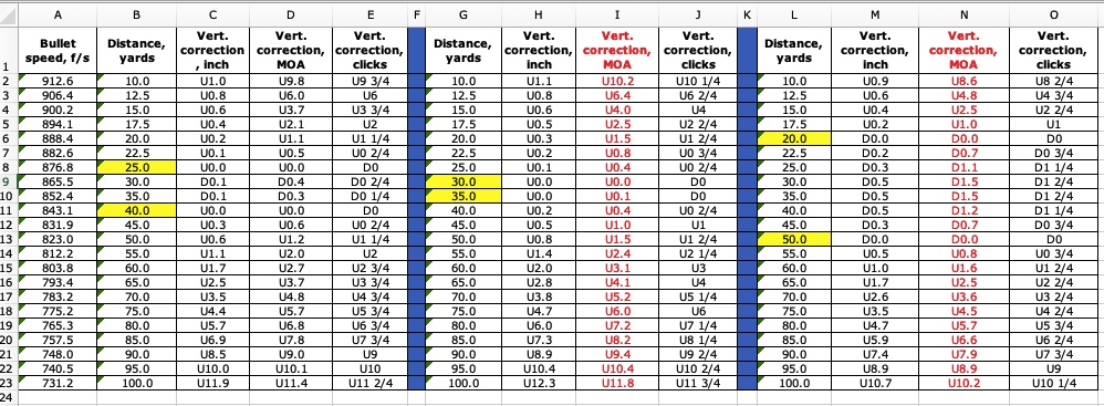

I set up my 22 paradigm with redesigned JSB's Athlon scope 2.25 above bore. I zeroed @ 50. Im setting around running numbers in strelok. Which zero bellow would you use?
25-40 is effectively zeroed for that entire range (0.1 inches holdunder at most), it covers the 30-35 very well. The 20-50 has 0.5 inches of hold-under which I'm not a fan of. It's up to your preference but that would be my thinking. I think the 25-40 is also an ideal distance for most pellet hunting.
My current zeroes are 20-40 with 1/4 inch holdunder. It used to be a flat zero from 20-35 until I moved to lower elevation, I'll probably pick a new zero at a flatter point in the shot soon.

I mostly agree with what's already been said. Clicking is allowed so take advantage of it and click for the match. If you truly have 1/2inch of holdunder it won't be a problem, given kill zone sizes and realistic amount of wobble you'll see in the scope (ie. you're a more stable shooter than myself if you can hold the crosshairs within 1/2 an inch.)
My method for regular and extreme ft is to simply make two columns on a sheet of paper. Left column is distances you want to know data for, right column is click value. Then I go shoot all those distances and write down the values. The more times (various conditions) you can repeat (read REFINE) collection of the data, the better your score will be at the match. (collection of the data = shooting all the distances).

To summarize, zero your scope for about 30 yards. That would give you something like no hold over or clicks needed for 25-45 yards (assuming muzzle speed of about 910 with. 22 MRDs). So I consider my "zero" the range of distances where no hold over or clicks are required.
I consider Strelok as predicted or suggested impact points, but it's best if shots can be taken at the various distances to gather actual impact points.
Let your experience with the shooting discipline, be it target or hunting, dictate the zero range you choose. With ballistics similar to yours, I've been using a 40 yard zero for the flatness of the trajectory. It is essentially flat within 1/2" from 15-50 yards. I do this for quick hunting shots and nominal yardages and also because I usually dial the scope for long range silhouette shooting also. With a 40 yard zero there's only a few yards where the hold under matters, by less than the diameter of the slug. Keeping your scope close to the bore helps here also.
With a 30 yard zero everything is a holdover, but you need to be more precise just past 30 and beyond because it isn't as "flat".
Because a 50 yard zero has a longer yardage range of hold-under, from 25-45 yards, there is more of a possibility of hold error there if your shooting at small precise scoring targets. This zero range isn't too bad for a hunting rig though, because it is within 1/2" of flat and only requires 1/2 mil of hold under for those 20 yards, and 1/2 mil holdover out at 60 yards. Again, it is probably best to let experience and the shooting discipline decide.
