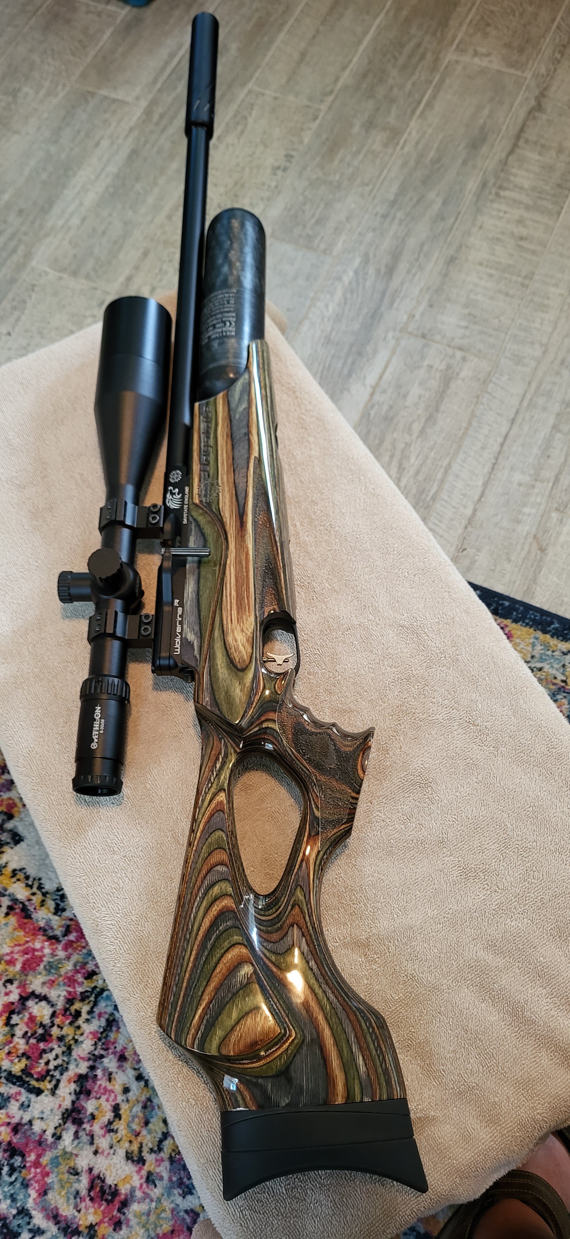

It is this one with a 700 cc bottle:

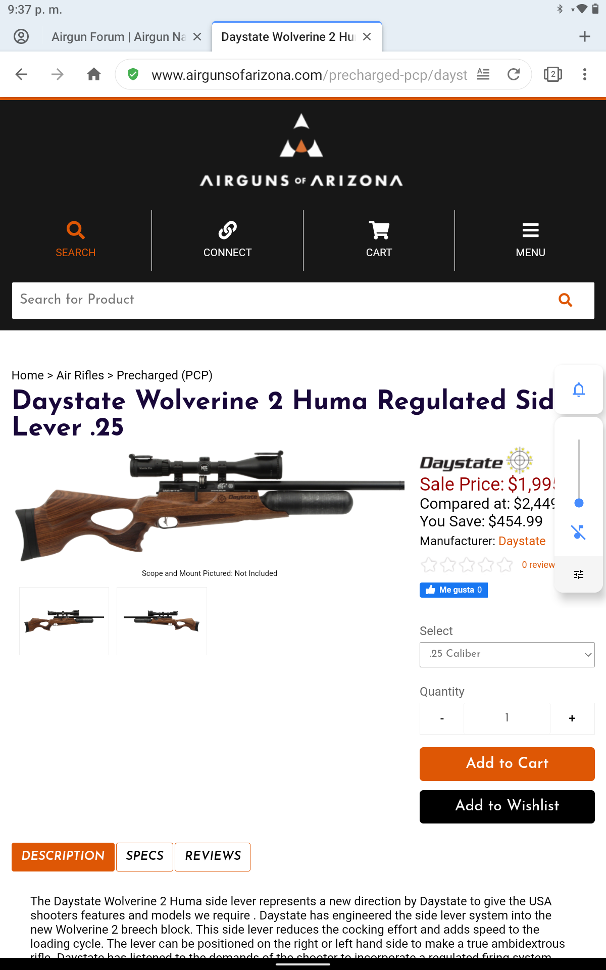

I was simply going by the specs page at fxairguns.com and daystate.com

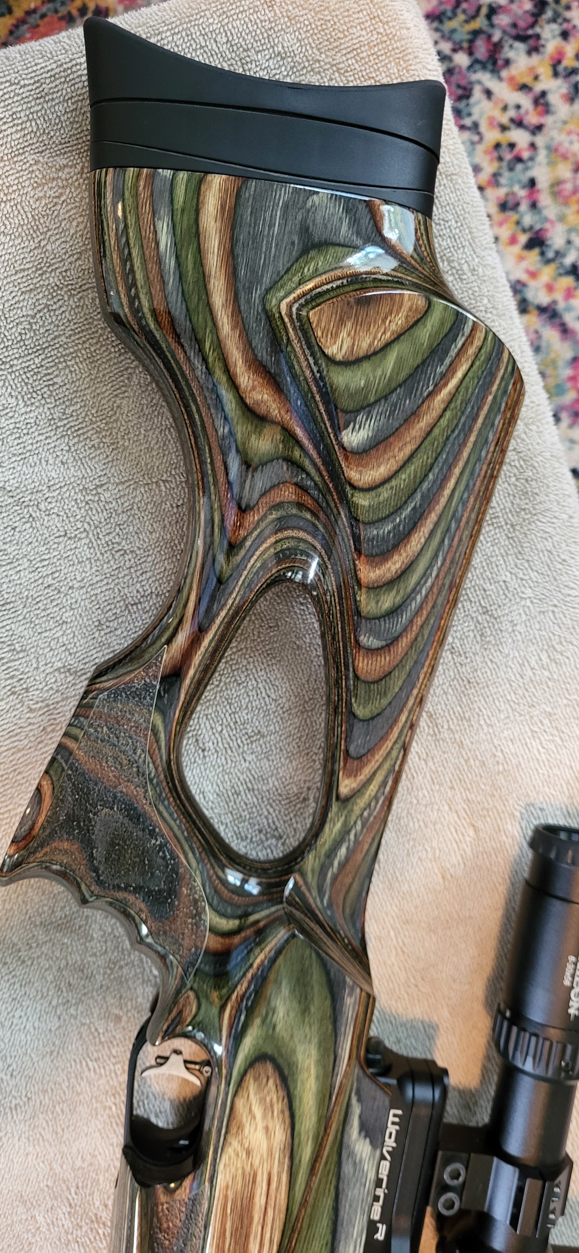

I own a daystate wolverine hi lite in .25 and two crown mk2 both with grs stocks. My wolverine is in a walnut stock and its a little older so the grip has a slight difference in grip. No finger grooves but other than that looks like the same shape stock. My wolverine is accurate but I dont like the grip or the cheek riser. The grip just doesnt put my hand where I like it shooting off a bench and the cheek area is very thin and has allot of slope as you can see in the pic instead of straight line like the grs stock. Again something that bugs me shooting off a bench. I really like the grs stock and it fits like a glove and I feel like I am in a more natural position while bench shooting over the wolverine stock. My wolverine never gets shot since owning my crowns and impacts. The wolverine is accurate I just dont enjoy it as much as my crown mk2.
