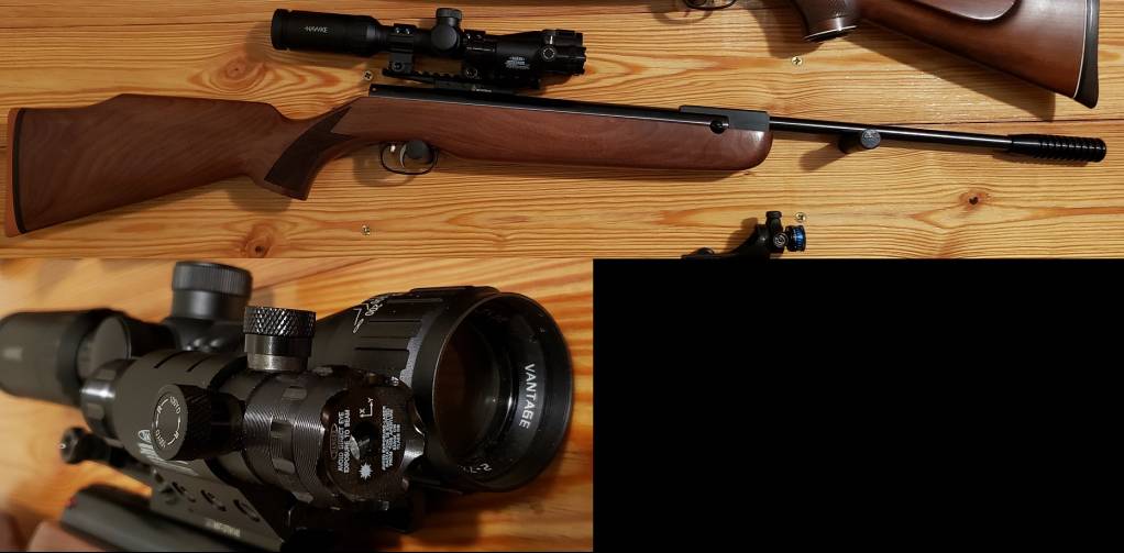

I've got a HW50 in .177 cal that I bought for Iquana hunting in South Florida. It's got a Hawke 2 x 7 scope co-sighted with a green laser at about 20 yards, which is the approximate distance that we encounter the Iguanas. Using H&N Field Target Trophy pellets at 8.6 grains, it chrono'd at 780 fps at 11.7 ft.lbs. I'm wishing it had a little for power as those lizards are hard to drop. All this talk of these Vortek kits( PG2 thru PG4). Are these kits for increasing power? Or for smoothing the gun out and making it more pleasant to shoot? I've heard that increasing velocity means a corresponding lose of accuracy. Any suggestions or advice - I need to ramp this gun up a notch or two but can't afford to lose too much accuracy.
