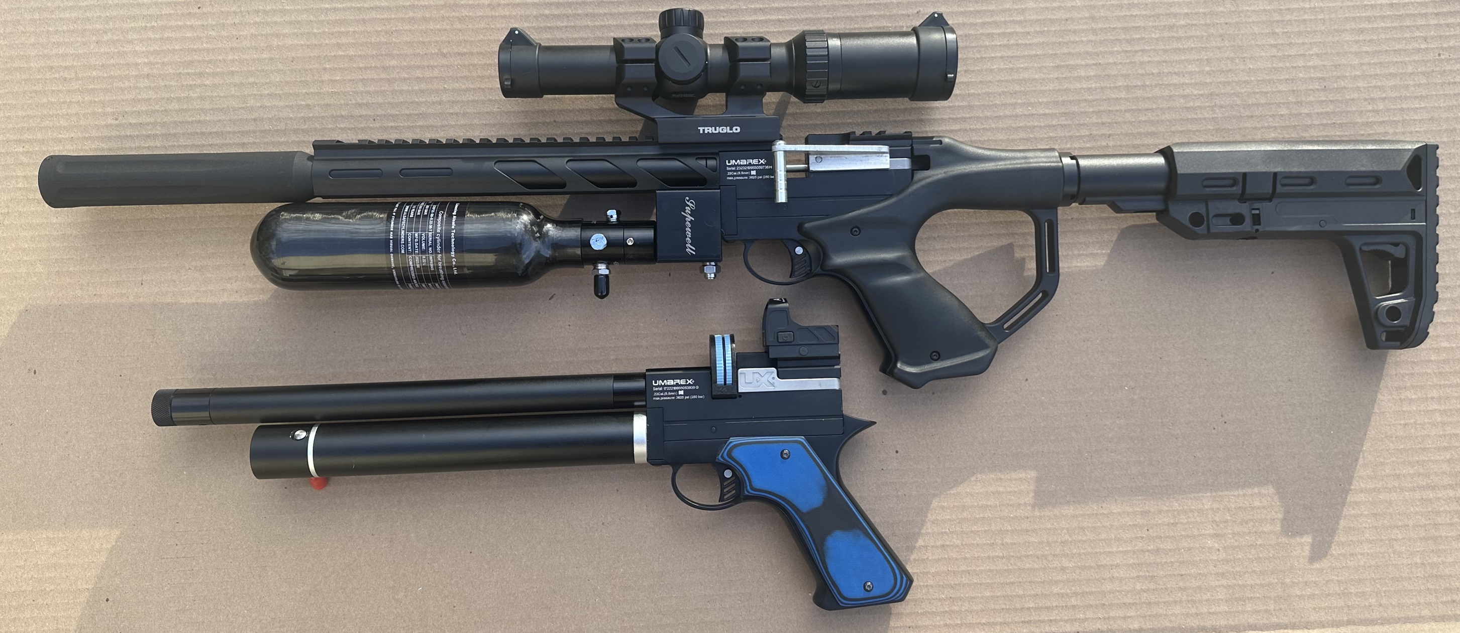

How does it do as just a pistol? Thinking about getting a notos but use it as a pistol only.
A little large, but manageable. I like it...

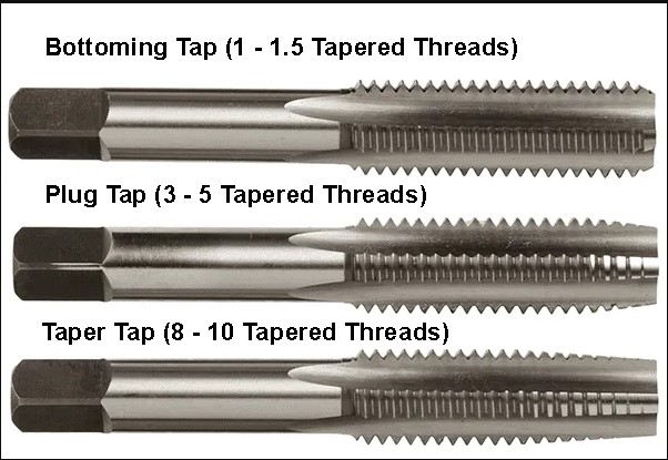

Actually, there is a little more to it than that. You need a 16X1mm bottoming tap, most taps are tapered or plug taps, neither will work. You will need to tap until it stops against the back wall to get the taper past the last needed thread. Failure to do so will roll the last thread.
