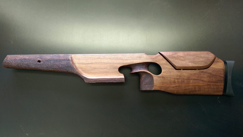

this is the UK stock i have on my HW97K but no stippling on it .
