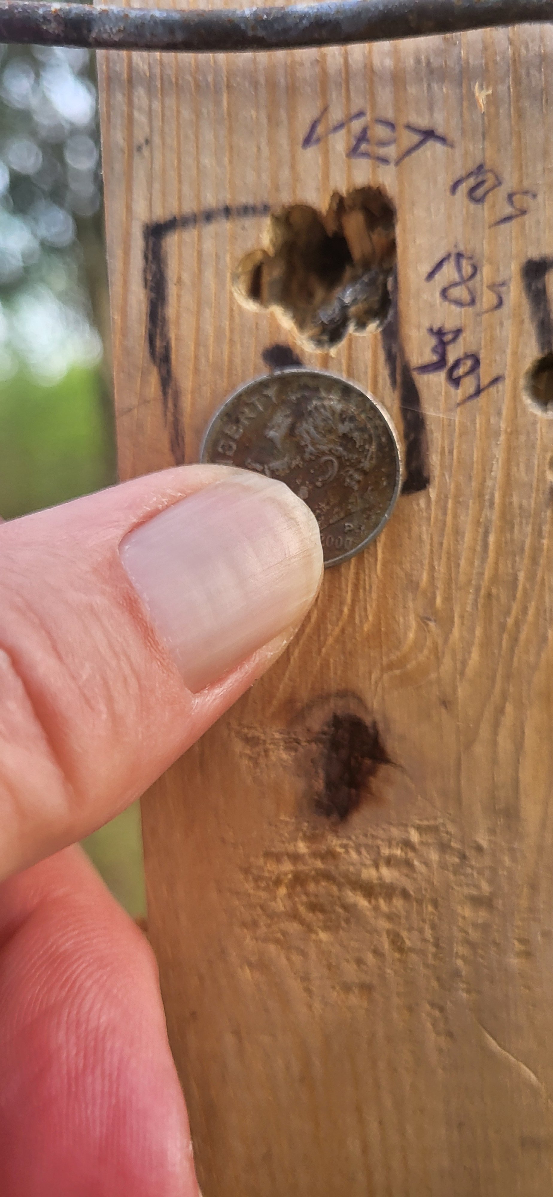

OK...In that opening statement of questions the words "you or your" was used 8 times, so from my chair with 64 years of "pulling triggers" a couple thing specifically about PCP's I've learned and internalized...works for me. Any of the better known brands, (I don't wouldn't never will go cheap) than try to make a silk purse out of a pigs ear. Companies like Daystate, FX, Kalibergun, Taipan, all guns I've owned and various models, In my experience, these companies know something about setting up their guns...the regs hammer springs ect at least close enough out of the box...WITHOUT RIPPIN' 'EM APART with out even giving them a chance by breaking them in and getting to know the platform, something I feel is very understated could take weeks or months only than more often than not I only tweek the Hammerspring and trigger externally, only ever messed with the reg on an Impact X with excellent results. Simply stated great trigger (Taipan Veteran) is paramount, be wastin' my time with unpredictable triggers AND getting to know my platform, practice shooting the thing, can't say I've never had a reg issue but that's the exception. Send me a new unmolested example of the afore mentioned examples and give me a couple weeks with it and historically sub half inch groups at 50y were the normal just trigger and hammer spring adjustments....My Veteran and Bobcat are years old and never even thought about messing with a reg. Not a lot there but for me less.is more with PCPs. Note 10shot group (30y) from two days ago shot from my chair...no.bench...THATS what a great trigger will do for you (me.)
