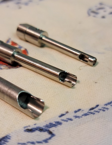

So seeker do u have pictures of your ported probe
I have 3 that I'm working on for my MKII in .177, .22 and .30
.30 is done, .22 I polished tonight after the photo and the .177 I will do tomorrow.
