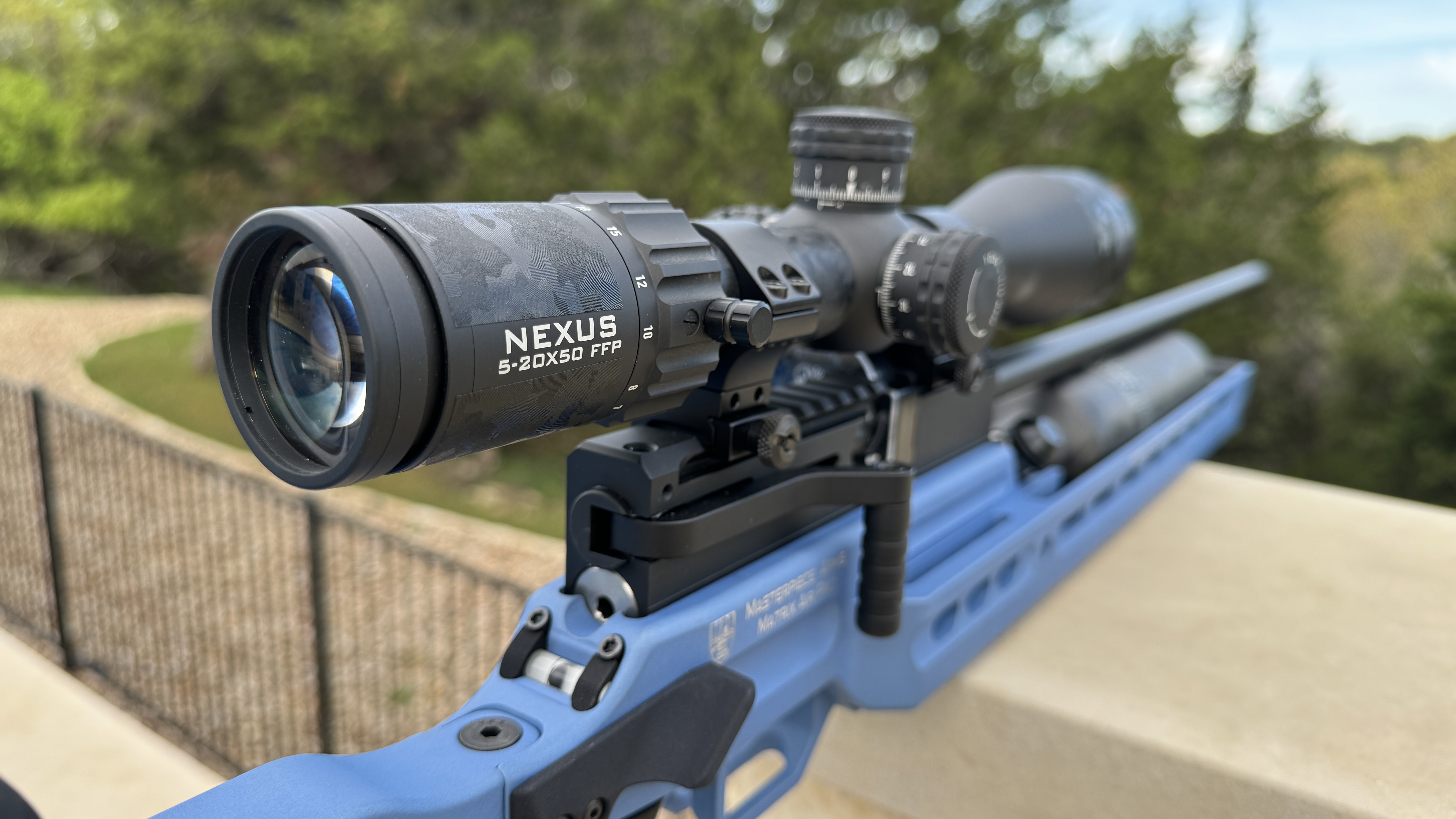

This Element Nexus is crystal clear all the way up to maximum magnification and still has a pretty forgiving eye box.

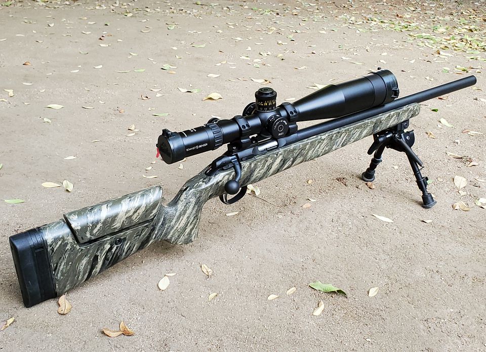

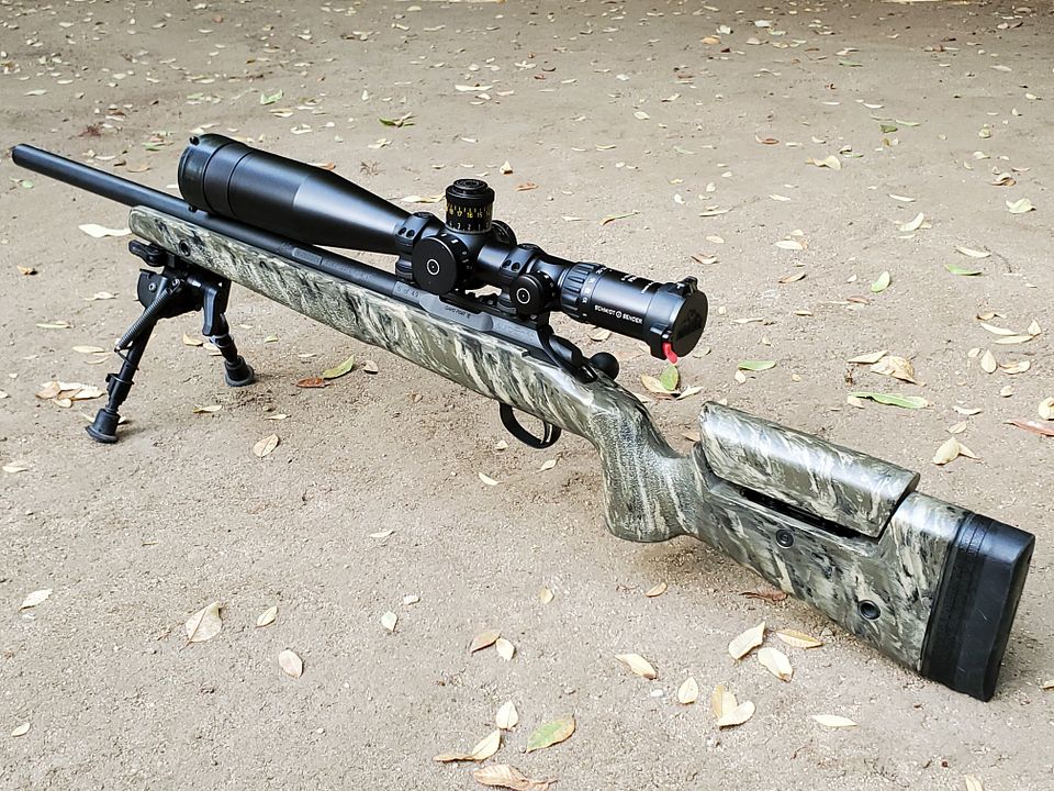

Below are two photos of my euroOptic Sako Quad wearing it's PMII 5-25X[56] 0.1 MIL CCW w/Gen 2 XR in APA 1.031" Rings on custom titanium Murphy Precision 45 MOA Picatinny Rail. Threaded into the Objective Housing is a 2" USO ARD made specially for PMII 2-25X[56] scopes.
Here's my 22" barrel Tactical Operations X-Ray 51 (.308) & 26" barrel X-Ray 66 (.300WM) wearing PMII 5-25X[56] 0.1 MIL CCW w/Gen 2 XR in Mark 4 1.06" Rings on 45 MOA Two Piece Picatinny Bases. Threaded into the Objective Housings are 2" USO ARDs made specially for PMII 2-25X[56] scopes.
22" barrel Tactical Operations X-Ray 51 (.308) in foreground, & 26" barrel Tactical Operations X-Ray 66 (.300WM) w Tac Ops Brake in back:
