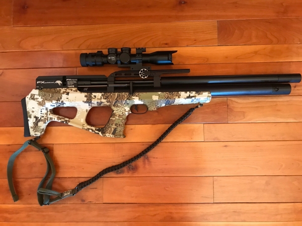

I have MTC Viper Connect on my Wildcat. It is a zero eye relief scope.
