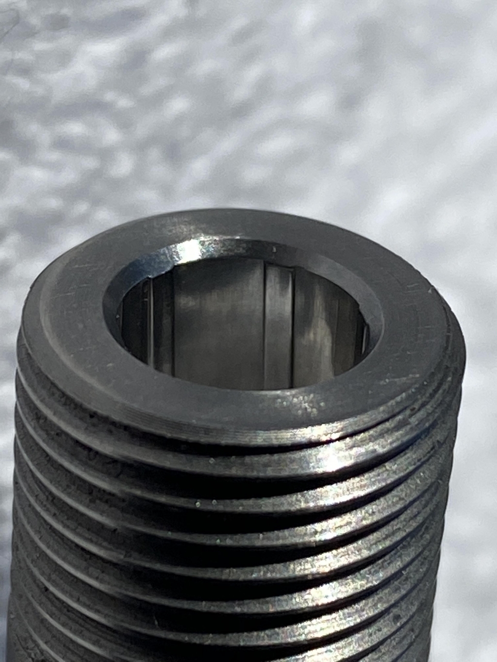

Where is the crown?

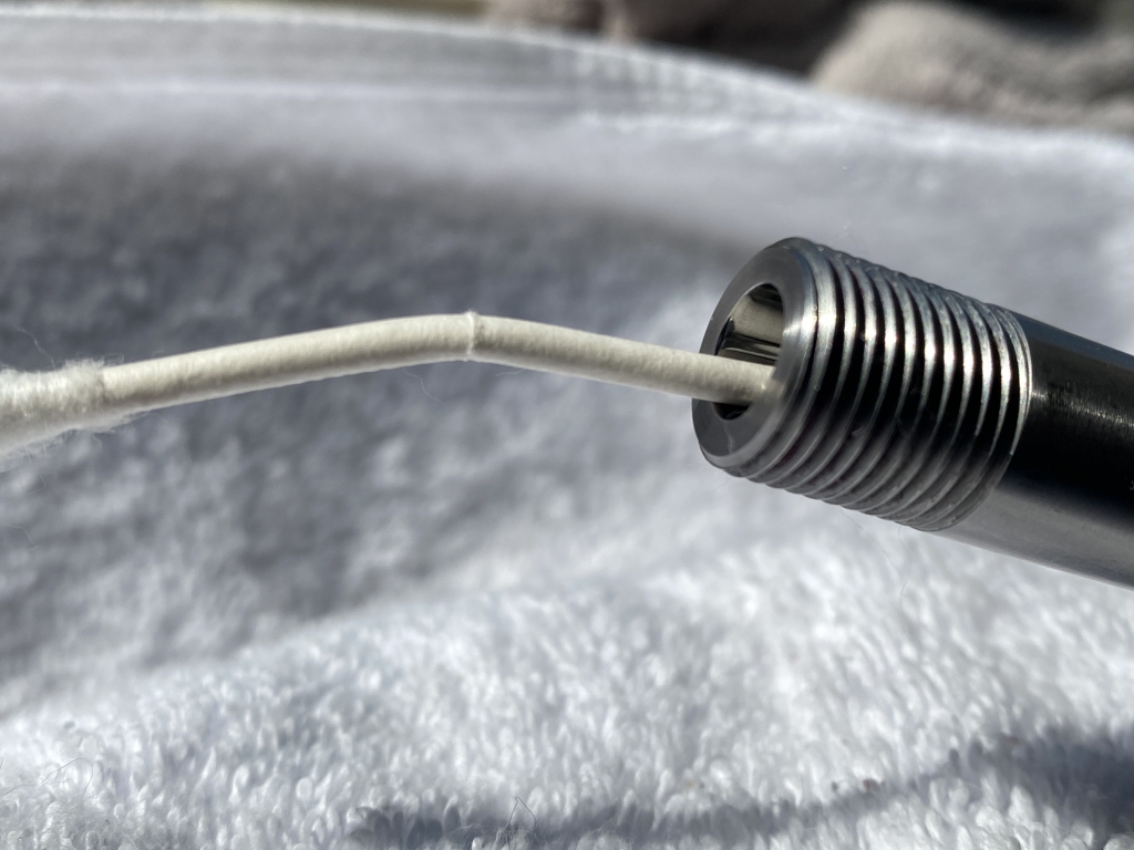

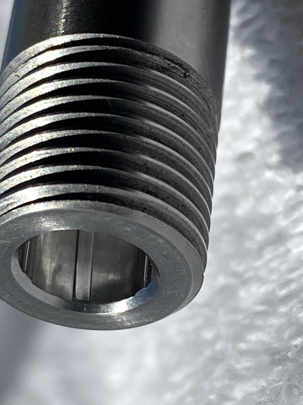

Where is the crown?
On the other end 😂
There's a cotton patch stuffed down in there, but I'm not one for macro photography with an iFail camera 😆
