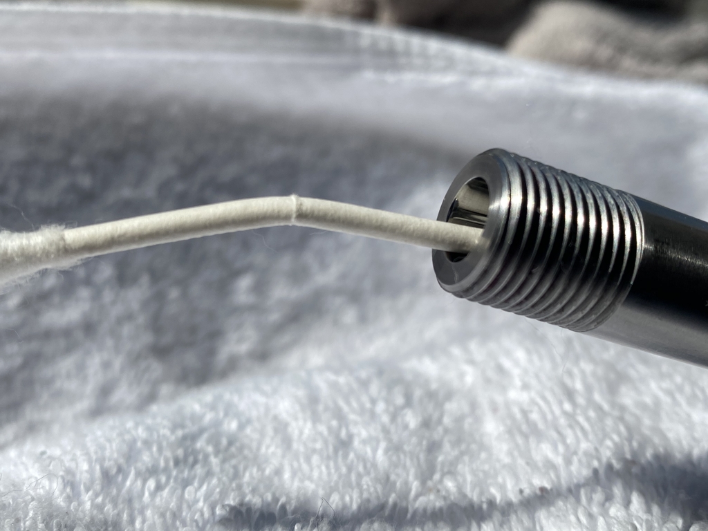

Db... it feels like you're running your pellet over a cheese grater and the bore diameter varies tremendously. I've hung onto it, thinking I'll spend some time with a lap. Actually, the choke is crazy tight as well. Hafta cut that off....
