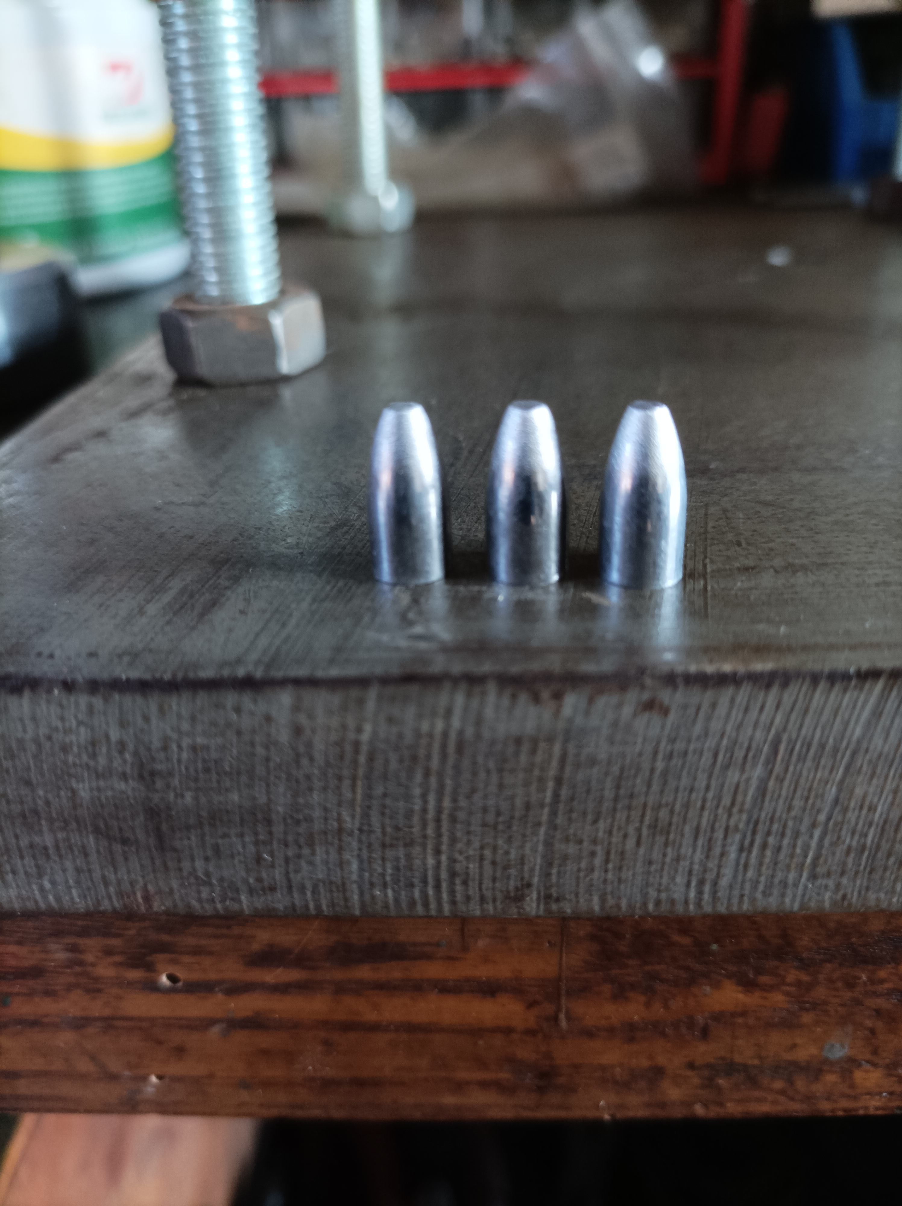

what you mean your own slug ?
you have mold for it ?
oh yea what slug weight in .30 dynamic "love" ?
such slugs. I made a die and a press so I could make them at home. for now they are G5 shape to G7 shape, I still need to solve the outer bevel of the projectile.
just what I'm making, I made it for my 1:16 slug liner, just the fx for these liners uses hard choke which is wrong, so that's why I own slugs. diameter is 6.33 and length 12.95mm ballistic coefficient in worst conditions high humidity 95% bad pressure etc. is 0.22 in ideal conditions is 0.39 and classic conditions 0.29 it is rounded to two decimal places. for calculations I use 0.27 at 290ms. measured in different conditions on two chronos. one at the barrel and the other at the target at a distance of 86m
