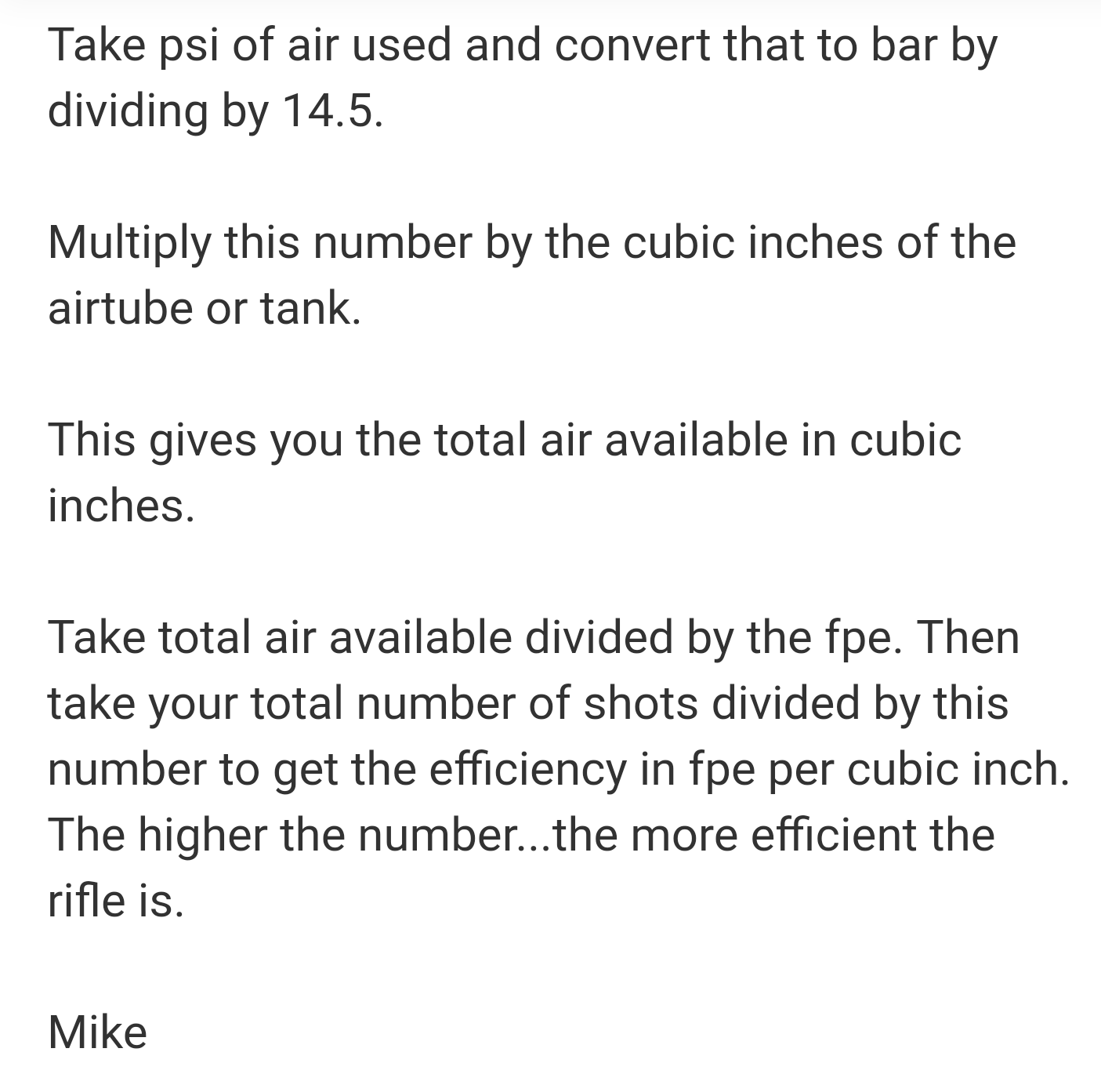

Here's the formula for converting total air usage into airgun efficiency. Efficiency changes relative to the gun's tune and projectile weight.
*Total PSI of air used ÷ 14.5 = Bar
*Bar × total Cubic Inches of air cylinder volume = total air used
*Total air used ÷ calculated PFE of current tune and projectile = X
*Total number of shots fired ÷ X = Efficiency in PFE per Cubic Inch
.75 is poor,
1.0 is still fairly poor,
1.5 is very efficient.
