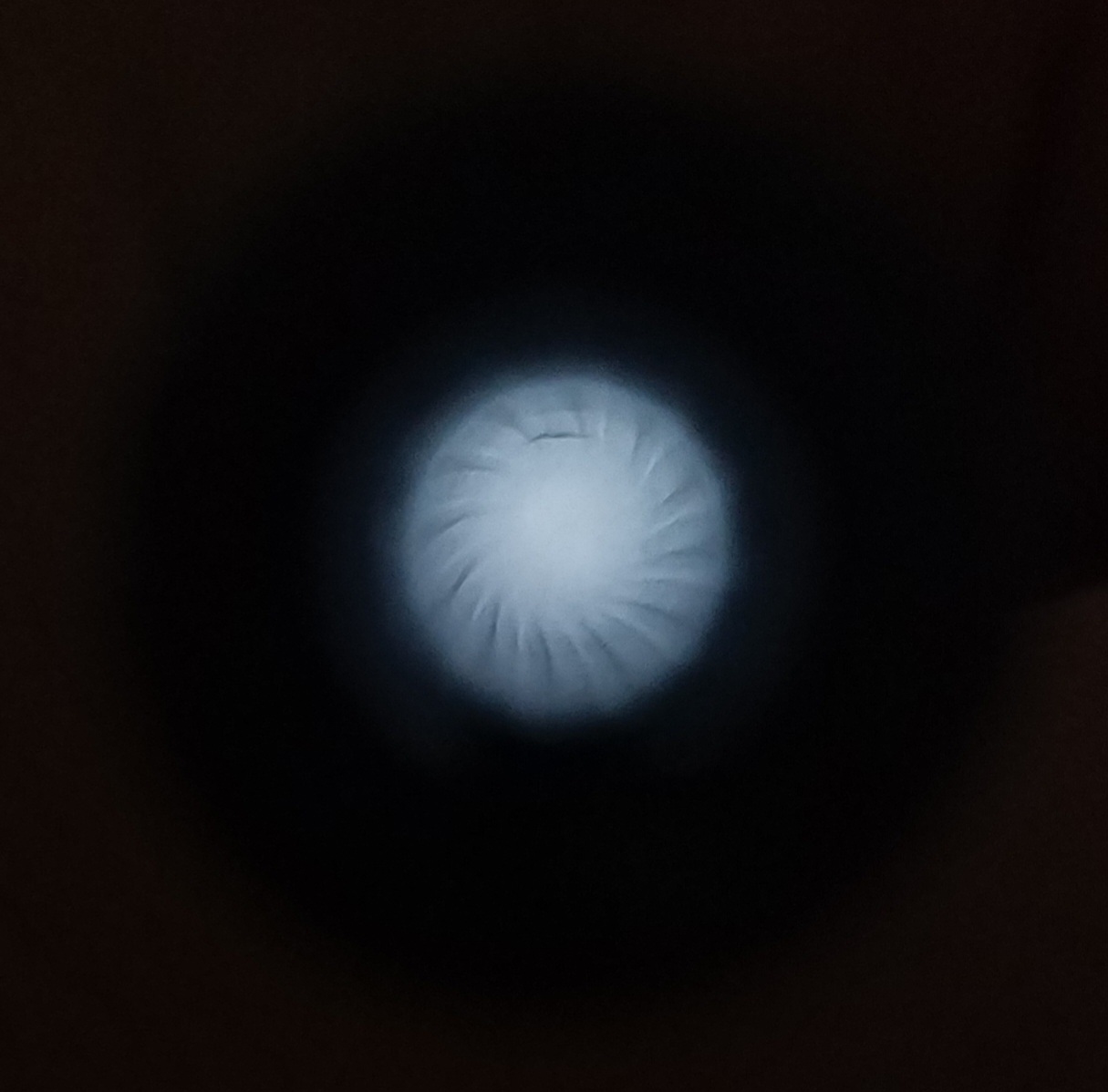

Speaking of the avenger barrel here's a picture showing an imperfection in mine about 2 inches from the breech end. I not sure if I made it when hammering out a jam with the first thing I could find which were some welding rods or if it came that way. It still shoots pellets fine, maybe because it's choked
The indent might be from an over torqued barrel retaining grub screw since it is at the top and doesn't follow the rifling as far as I can see. When I pulled my barrel last I saw similar thing but same here it shoots pellets fine and slugs too so I guess the pellet or slug gets fixed by the rest of the rifling the rest of the way down to the muzzle.
It's been suggested on here that next time the scope is off and the front rail is off you take out the barrel retaining screws and round off the sharp tip with some sandpaper so that when torqueing them down it doesn't push as far or put a point like what we see here but are still tight to secure the barrel.
Reactions: skeeekerz
Yep mine had both indents one for each grub screw. I also like stuff tight and always have to catch myself from over doing it.
Apparently the .25 cal is worse offender as it's barrel wall is thinnest
I pulled mine down right away and filed down those grub screws. They have a sharp point on them from the factory and some barrels get damaged upon initial assembly.
