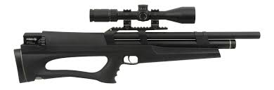

This all started when I saw a Joe B video showing he could shoot a super heavy .22 slug out of a Huben K1 at super sonic speeds...way faster than you would need. So then I wanted the MOST accurate Huben I could get...couldn't decide between .22 and .25...

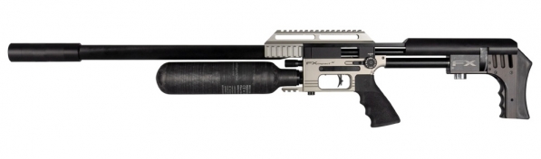

Now the problem is spilling over into ALL my top end gun purchases. I want a Crown this week and so now I can't decide on a .25 or .22.

 Crown
Huben K1

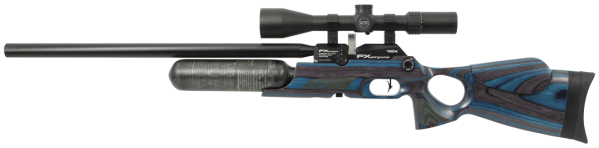

Impact X
