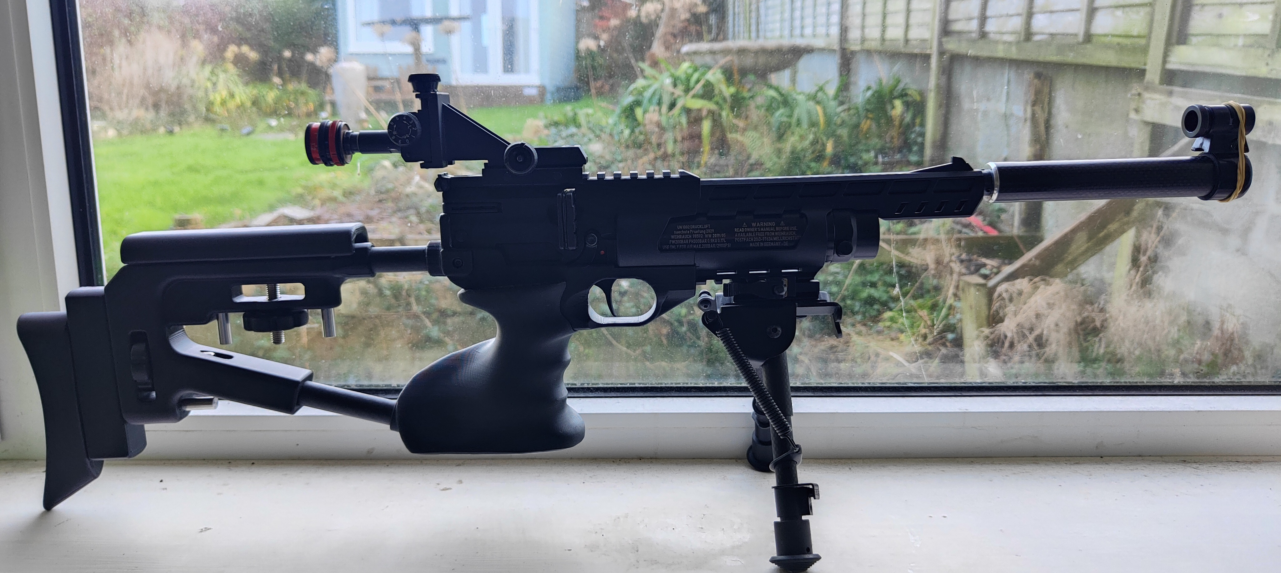

I have the HW44 which is a scaled down version of the HW110. I really like the pistol. My only complaint is how fast it shoots pellets. Twenty shots on the regulator. Very accurate and 12 fpe in a pistol is impressive. The only reason I do not have a HW110 is because I have no room left to store it.
I also have the 44 but we are limited to 6ftlbs. Ridiculous.

telephonepete, how do you like that shoulder brace/stock? are they still available?

I have a used 44 being purchased, so that is why I ask about the stock/brace
Stock superb. I bought it as a job lot so never used it as a pistol. Its just to much fun as it is. Great stock so adjustable and only about £90. Again available on the AIRGUNFORUMS.
