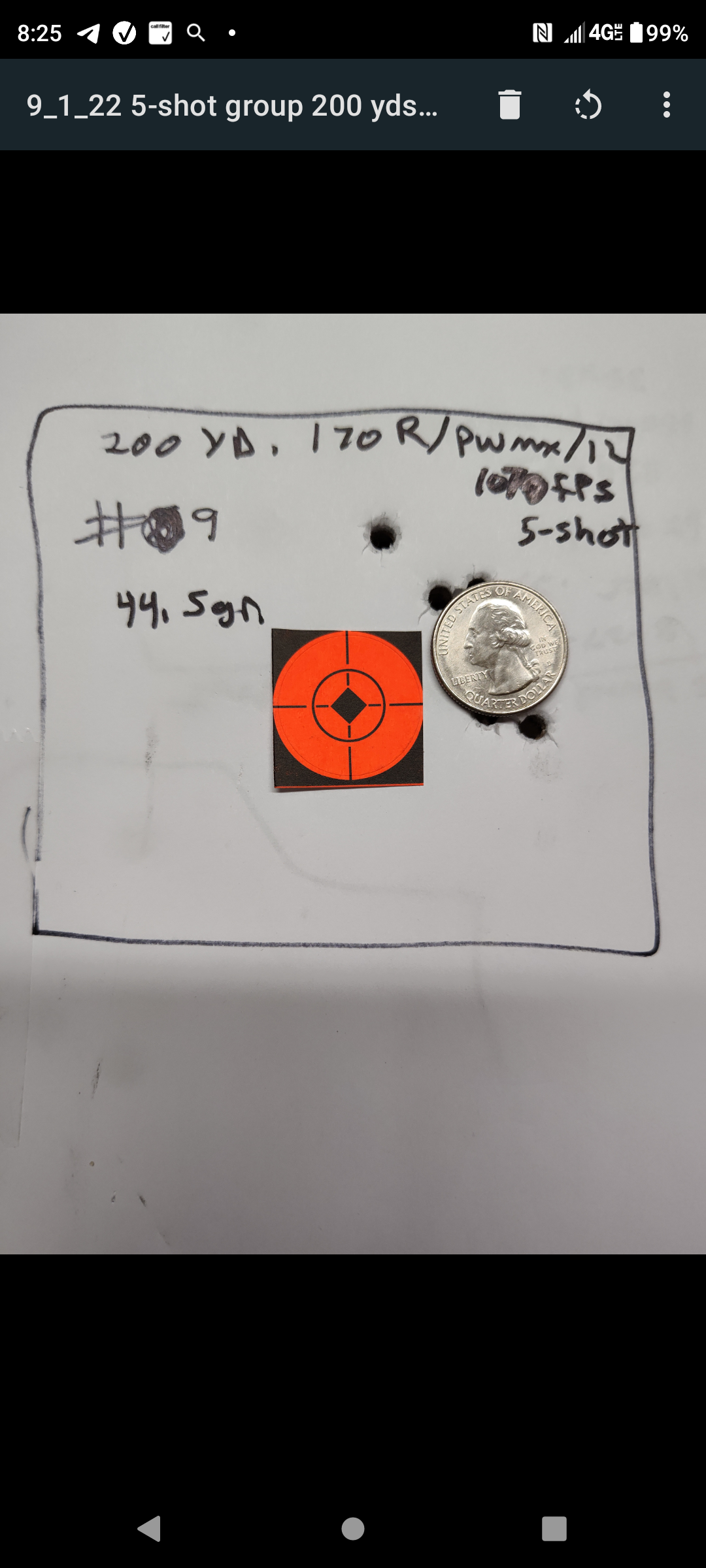

Thanks all! Biohazardman, are you getting anywhere close to MOA at 200yds?
200 with an airgun? Try 100 realistically. With some slugs you can have more distance. I can't speak for @Biohazardman but in general 125 yards and under is more in the airgun arena. Most people have a very hard time getting 1" groups at 100. It takes practice and skill, which is something some guys achieve with ease here with their skill level. But it isnt as easy as 22lr is my point I guess

My .30 cal is my most accurate gun in the 100-300 yard distances. With very low wind I got this group.
