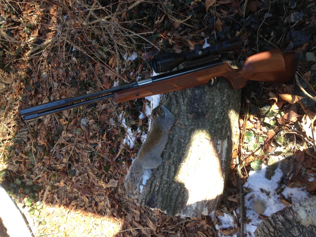

Hey Christian, that top rifle is a.22 R9 with a chopped barrel and a steel sleeve for looks. I made that stock myself out of a walnut blank.

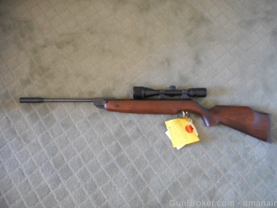

The second picture top rifle is a.177 95 with Williams peep and the bottom rifle is the old style HW77K.

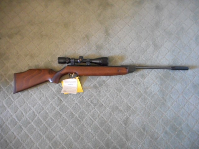

Bottom picture top rifle is what I call a HWR95. Its a . 177 95 action in the original stock that the R9 (very top rifle) came in. Bottom rifle is the HW97K in .177.
