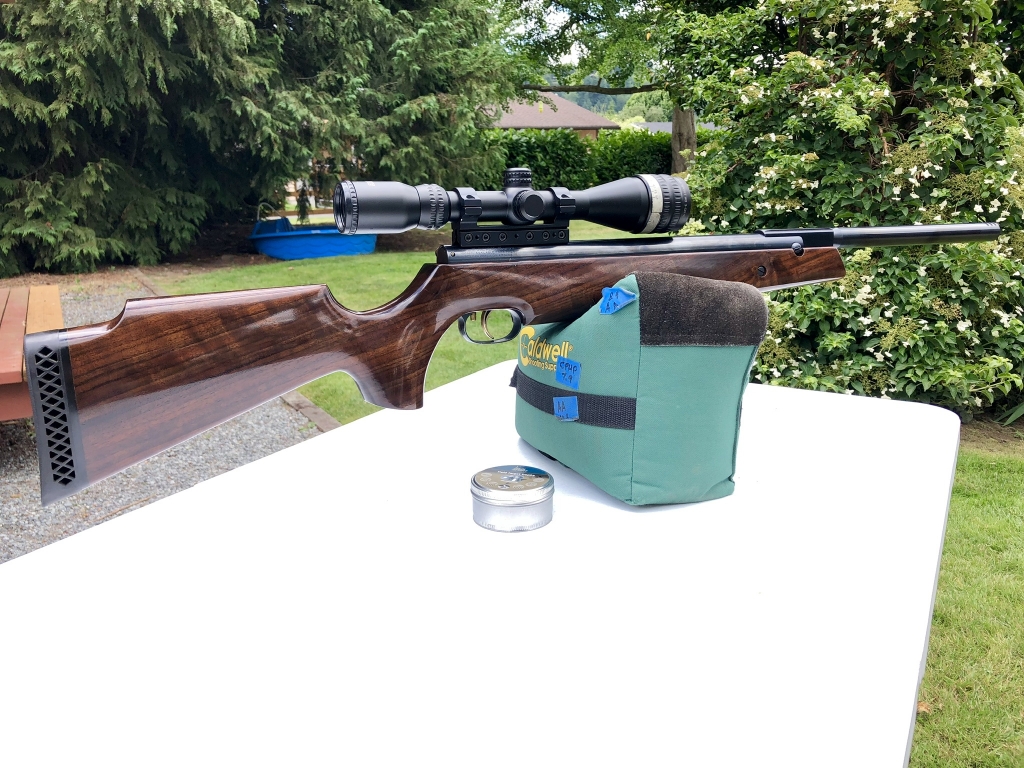

Just to get the flames fanned....
1570110069_16152586265d95fa754bed84.72789835_73C5283B-AD5B-4E1D-8D9C-75F5299E3B80.jpeg
@Greenarrow
That’s a very nice gun up there. Is that a 95? Sleeved?
