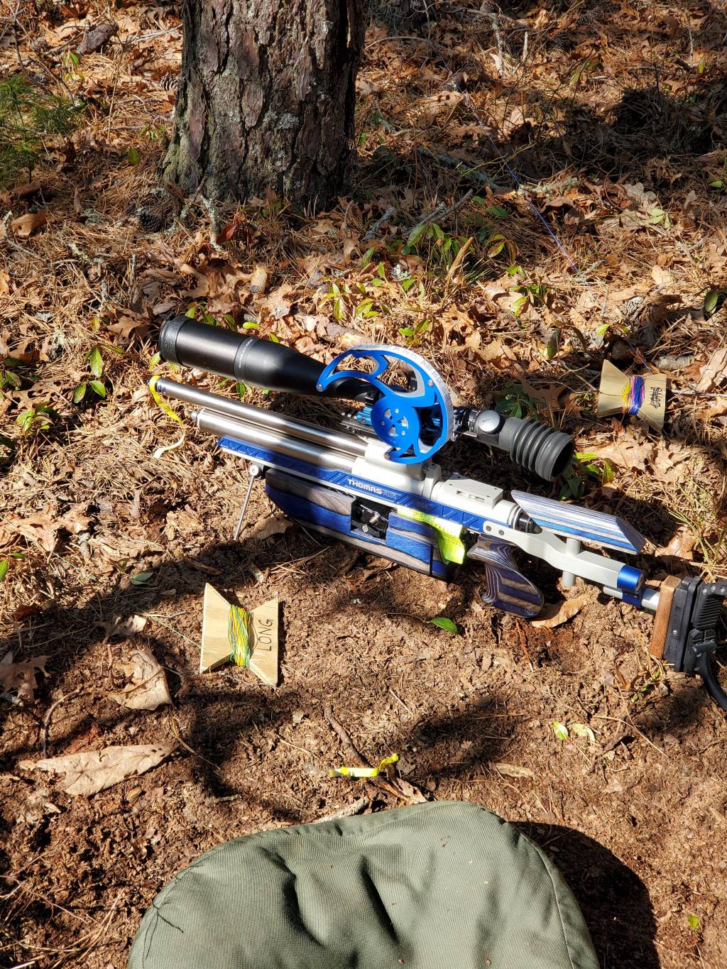

Mine is fixed. Once you like where it is on the stock there's no need to move it unless you disassemble the gun every match for travel.
There is no disassembly required to install the unit.
Also it can be installed with the lever on either the left or right side of the gun. Mine is on the left as I shoot right handed and find adjustments are made easier with my off hand.
I have tried a number of brands and settled on a MAC1 that I make my own palmrest for and "tune" the adjustments. I can make elevation adjustments for fine tuning NPA using cheek pressure without hands or breaking position. Try that with the one most liked above. I have several of the MAC1s all set up identically. In the end it is a personal preference and any of the above hamsters will not make or break your score.
