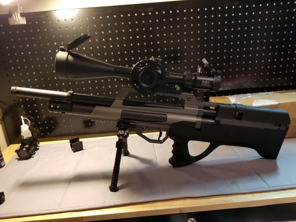

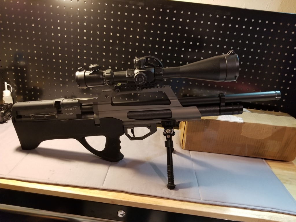

Another option is the Evanix max air bullpup. I have this in .25cal and it is lite but packs a punch. Follow up shots no issues, crisp lite trigger 9 round magazine fires as fast as you can pull the trigger in semi auto. Accuracy is spot on at 50 and 1/4 group at 75yards. I shoot 7 mags before i refill. Fits nice against the shoulder and is alraedy threaded for a moderator. It is not super loud but a moderator woiuld make it very stealty for medium game. I am shooting jsb heavys at 880fps. length is 30" overall, wieghs in at 5.3 lbs without scope.
