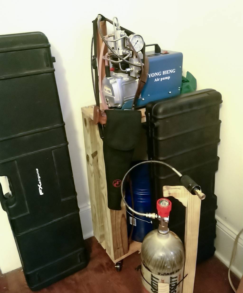

Which version of the Yong Heng are you getting? The cheapest "Simple" version lacks a Cyclone water separator, which you need. You should get the "Hardcover" or "Set Pressure" versions.
My initial set-up is with 12" aluminum gold Tuxing, the small black (cotton filled) YH filter, attached to bottom and 4" blue (cotton filled) filter, attached to top. I'm using in humid Florida garage and may need to improve with $132 water removal system, if this set-up fills with water.

My setup is a single extra filter in addition to the YH filter. I've not had any problems with water in my tanks. Removed the valve from one last week, no sign of water. It's a very simple setup. I do replace the YH filters relatively frequently. Just keep an eye on them. The YH filter catches most of the gunk, so I only change the secondary filter when it needs it and that's not very often.
Your AGN info says you are in New Mexico. I would probably get a single extra filter, and bleed the water side (right side bleeder valve. Left side is to bleed some oil residue) every 3 to 5 minutes for a couple seconds, just enough to see the spray stop. You'll understand the first time you do it. From my experience in Utah, bleeding frequently and using the single extra filter is probably sufficient. Try it and if the second filter gets wet, either bleed more often, or get extra filters. You can build from your experience.
